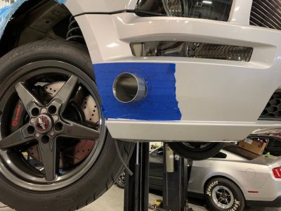

sorry that was 3" exhaust that dumped under the passenger side floor board, no mufflers, when I was running 3" full exhaust with mufflers, no CATS, and an X pipe I was around 850rwhp, when I got ride of the exhaust and just dumped it I picked up about 150rwhp. Wasn't easy getting to 1081 with that little turbo, poor thing is completely maxed at this point

I had back pressure issues too and went to a front exit exhaust that gained around 100 hp. I know someone else that has the precision 76/75 Gen2 CEA and is hitting about 1,000 rwhp still running the draw-thru setup. I've changed mine to a blow-through.
