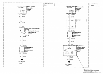

So I completely finished putting my freshly built 4.6L into the car and rewired the harness and tried to go and start it, I hear everything ready to crank except.. the starter luckily I’m good with diagrams so I traced it down to the auto shifter position switch which I suppose I can refer it to the safety neutral switch..? The car doesn’t want to crank because the starter circuit is not being complete.. any ideas?
