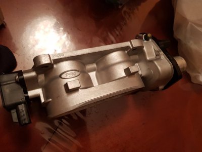

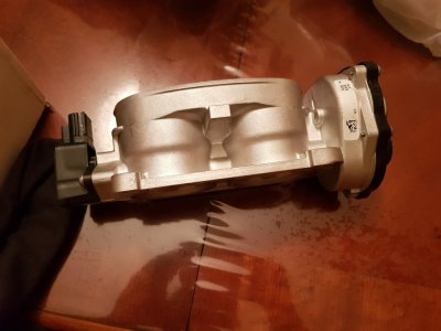

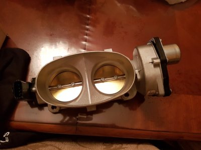

20190623_005908.jpg 20190623_005927.jpg 20190623_005915.jpg here's the throttlebody I have. It came pre-assembled. Do I open the side to adjust the voltage?

Is that a gt500 throttle body? If so thats the issue, it needs an adaptor plate or it will not sit in the correct position causing vacuum leaks. If not, then disregard.

quick google search of the G273n casting on the throttlebody looks like its a gt500 60mm throttlebody and wont fit right on your intake. Im not aware of a 62mm throttlebody made by ford for a 3v. Ford racing makes one but it is shiny chrome and thats obviously not what you have

That's a gt500 60mm tb. Unless tps voltage is exact no canned tune setting will even remotely work. What is your setup that warrants it? Unless its max effort na or boosted with custom tuning dont bother, put your stock tb back on and leave it alone.

that looks like the regular factory 3v throttlebody
