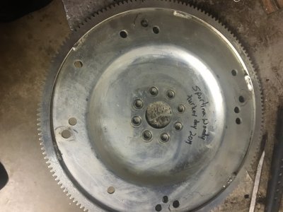

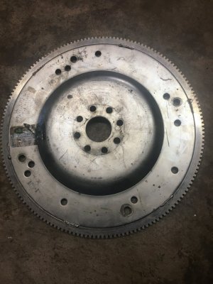

sportinawoody
Aug 10, 2008
2,378
36
Piedmont area , N.C.
i have an extra sfi as i thought they were different and ordered one for a coyote, i was disappointed when comparing to find out they were both identical in every way including height. my extra is an 8 bolt though if you need it
daviswarner192
Nov 5, 2019
23
Thanks for the offer, sticking with the 6 bolt crank for now. Down the road when i rebuild the motor I'll probably go with a 8 bolt.
