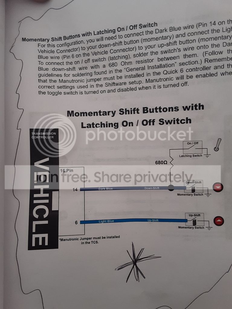

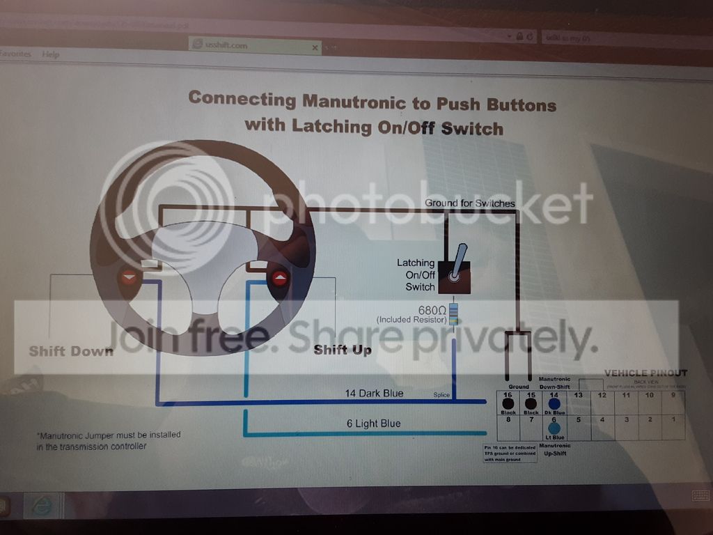

    I wired in my manutronic today with a latching switch using the amg paddle shifters and it works great.... super quick shifts. Unfortunately when i disengage the manutronic and put it in conventional "drive".... the car doesnt want to shift itself anymore. Even if i disable the manutronic in the transmission tune, it still wont shift itself, although the quick 6 is showing It being in "drive". Anyone have a problem like this? I assume i have something not wired correctly but i wired it just like the manual says under "momentary shift buttons with latching on/off switch". Thanks for the help
  6. chad Cini
    chad Cini Junior Member
    I wonder if it has something to do with why they have updated the manual with a different wiring diagram.... seems like there is a few new things in there... i saw something on the trans brake wich wasnt in my original manual[​IMG]manual
