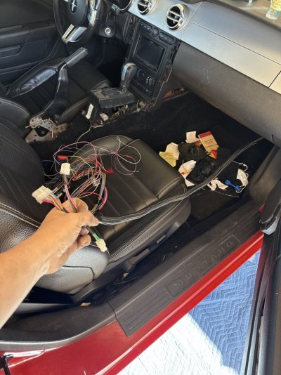

I thought I would share how I wired mine and my sons cars. First off YOU ARE 100% RESPONSIBLE IF YOU USE THIS INFORMATION. I do NOT have neutral safety enabled on these cars yet. It will start in gear.
All factory auto cars will need to have pins B9 and E10 on C1035A connected together as you no longer have a digital range sensor to make that connection on you trans harness. You will also need to ground pin 30 on 05’-06’ cars and pin 39 on 07’-10’ cars on connector C175T. If you are a stick car you can do this or connect your wires together at the clutch deactivation switch.

Trying to sort through a few issues on my car and my sons. They are both wired as mentioned above. Only difference between the two is his started out as a 2007 manual car and mine started out as a 2005 automatic. In my car I still do not have the lockout where you cannot start it in gear, but I do have my select shift working via the O/D toggle switch to engage. His car is wired the same as mine but I cannot get his select shift to work or his brake pedal interlock for the shifter to work. I have to manually disengage it in the shifter housing if I push the brake pedal, it will not release, Also, in the programming software for the quick six, his does not give me the option to select holding the overdrive button for two seconds to toggle on the select shift where mine does, and I have all the settings, the same. Anybody have any ideas?
I have my '05 neutral safety lockout wired in and the brake pedal tied to the shifter interlock (since mine was an automatic, it already had the little harness under the center console with the power interlock control, so just spliced the 6r80 shifter connector into using it and the brake-pedal release worked properly). Even though his is manual, if the harness is there, it should provide the voltage (or ground as appropriate). The '11-14 shifter interlock is the same as the 5r55s. It is possible that connection is just not completed because of being a manual, as that would probably go through the sjb for power. It's been awhile since I researched this.

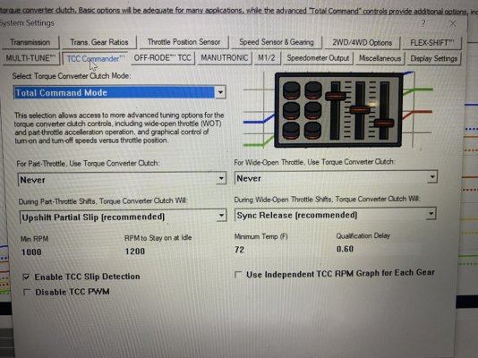

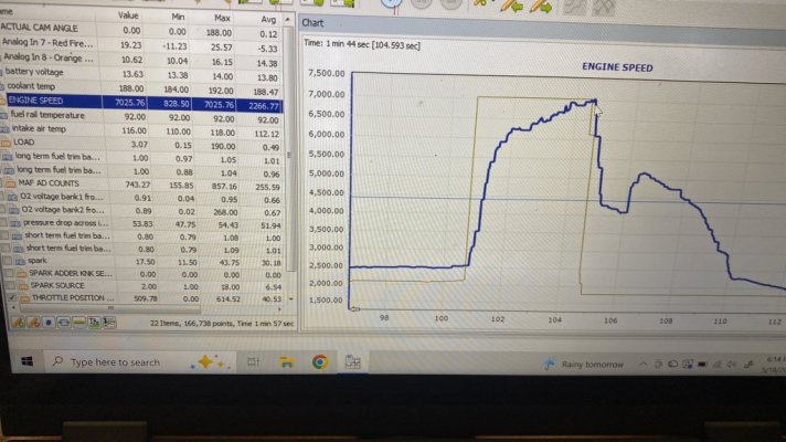

So, I'm going to throw it out here since this is where it all started and most of you have done more tuning with our Quick 6 controllers then I have at this point for normal driving. I'm having an issue with mine, (and have for a while) that when I do a WOT pull logging with my SCT I get a spike in RPMs after I let off the gas and go 0 on the TPS. here are a couple screen shots of the issue and the trans tune settings. Does anyone see something I am missing? I have the lockup turned off as far as I can tell. It doesn't affect anything except the RPM flash after WOT when I'm data logging or going WOT.
Just realized the pics are on my phone, update in a minute.
05stroker
Never enough power guy!
Mar 2, 2008
13,089
100
Bullard Tx.
It almost feels like the converter is locking, even though I think it have turned off, but maybe one of the settings I have there is making it engage after I lift

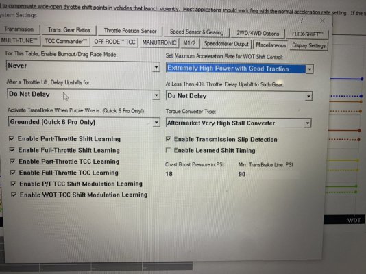

Hey 05stroker, quick question seems like you know about the 6r80 and quick6. I’m having some trouble with the TCC lock out, I shut it off until 5th since it was locking in 3rd going local, but now seem like the trans is slipping in or surging rpms when shifting 2-3 and 3-4. I’m very new to this and trying to learn how to tune. Any suggestions besides selling everything?
TexasBlownV8
Formerly TexasBlownV6
Apr 4, 2008
5,017
88
Central Texas
No need to "sell everything", lol. One thing I found helpful was to make sure the proper Torque Converter Type is selected (as shown in the second picture above); I had a different issue, and after speaking with tech support, went in and set the type that was appopriate for my setup. You can change where it locks up under various conditions, too.
You may get more help by contacting tech support at USShift; they are very helpful and can offer suggestions. I understand the feeling of "is there an internal problem, or is it tuning, or both?".
