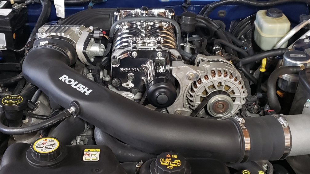

98B05021-21B9-4F5E-A084-31C9B8421F76.jpeg If and when the day comes, I plan on doing the same, build my 3V. Car currently makes 440 rwhp on 5.5lbs of boost(Roush TVS) and 91 octane.
