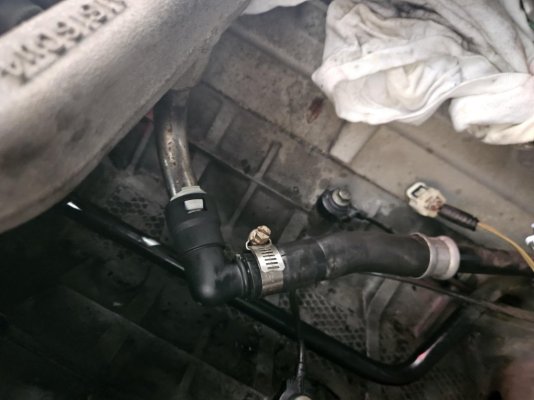

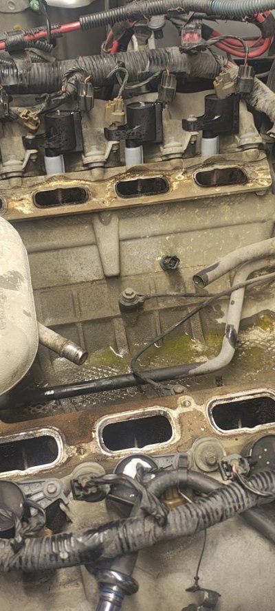

Tried to do the front-side (remove the TB and Alternator) repair, but was unsuccessful, so pulled the intake off and replaced the cracked elbow. Other forums (and posts) describe the slow leak and associated "gym sock smell", proved to be the diagnosis on my 2008. See the pics, as the engineers were nice enough to put a hole in the head cover, so the pathetically designed plastic elbow that would eventually crack and leak, to drain down the back of the engine. Many days, it didn't leak enough to even leave a spot, under the car, but would evaporate, before dripping. The smell was always there, however. I saw several videos, where owners used heater hose to circumvent the elbow, but they were all strangely bent and I went with the Motorcraft KT-92 replacement part and hose clamp as the fix. Hopefully, it'll last another 116K and/or 17 years ,before cracking/leaking again...

No leaks on mine, since the fix. It was leaking from the compression fitting on the original plastic elbow...methinks the hose clamp is better. If you're willing to cut both ends and then flaring the pipes, I agree that a zero plastic replacement is probably better, but so far, so good for me.
Them plastic quick connectors are ok for a long time usually but start to leak with a combination of age and heat making them brittle. There's a bit of a flare on the pipe the plastic elbow clips onto but none on the cut bit. The cut pipe on the opposite end is strong enough to support a jubilee clip good and tight and doesn't need flaring in my opinion.

If its only a small leak it will run down the back of the engine and off the bell housing at the flywheel usually. Mine only leaked after I parked it but not when running for some reason
My experience exactly. I first suspected something due to the "wet gym socks" smell, coming from the engine bay. Probably only leaked when parked, due to being burned off/evaporated while running.

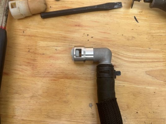

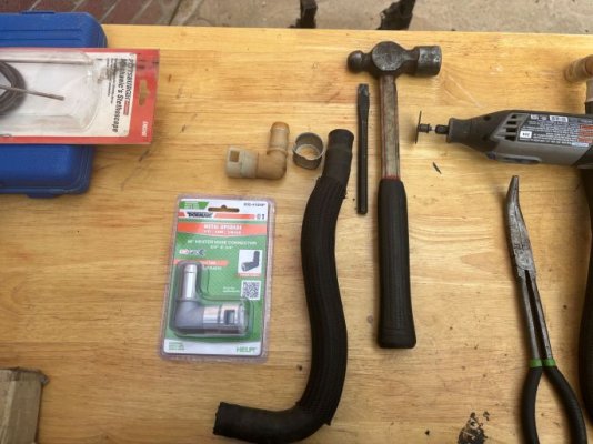

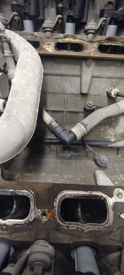

Got the parts this afternoon thus I started the 1st part of this upcoming job by removing the 2 plastic connectors from a spare set of 05-10 GT S197 heater core side heater hoses I'd bought used off a low mileage part out on EBay some 5 yrs ago (as I said in prior post, being proactive instead of reactive........FYI, also have the entire setup in hand as well as a spare if the need came to replacing the whole thing..........so I was already prepared for this exact scenario...........recently discovered the metal version connectors which redirected my preplanned repair process........).
Removing the crimp clamps is fairly easy if you have a Dremel w\ a cutter wheel.........just slowly cut across the crimp clamp using 1 of the crimp risers (farthest away from the heater hose underneath.......) until you just start to see that you're starting to cut thru, then use a sharp chisel w\ hammer to finish the split & spread it open to release the tension & pull the connector out w\o damaging the hose underneath.
Then install the new metal connectors & use the clamp of your choice..............I choose to use properly sized 30 psi constant tension band spring clamps rated for radiator\heater service......like the OEM's use...........all accessible on Amazon.
Pictures provided below.................
Will be using the same removal\reinstall process at the 3\4" hot side crossover end once I remove the IM to get it out of the way.............the firewall end is easy..........simply just remove the old hoses & install the newly modified ones..........if the old hoses still check out to be good, will then pick up 3 more metal connectors & convert them for spares & build a new 3\4" crossover section to have on hand for a spare as well........so going forward it'll be very easy to R&R the crossover section w\ the IM still installed...........even though they'll most likely not be needed.
Then, if the parts aren't too brittle, will salvage the white latch clips from the old plastic connectors to have on hand for spares as well. Also have a new CHT sensor on hand to replace the old sensor as well while I have the IM off to finish this up (have noted when running several Forscan KOEO sensor self-checks that the 17 yr old original CHT sensor keeps setting off a low-current pending fault code thus had already picked up a new FoMoCo replacement CHT sensor for whenever I had to remove this IM again.........another 1 of those "while you're in there" things...........).
Now it's only a matter of when I decide to do this...........again to be proactive & resolve all this up front before it strands me or cause further unnecessary engine damage.

Read here for final installation: https://www.s197forum.com/threads/w...ur-mustang-today.56419/page-1432#posts-28,625 & 28,628

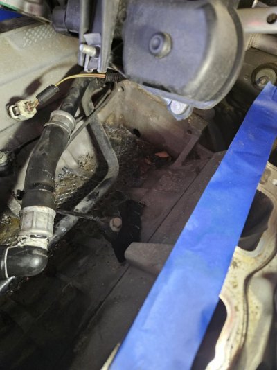

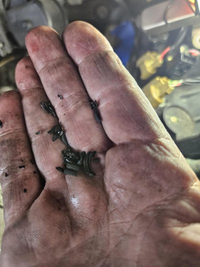

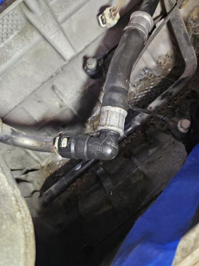

FYI for those so interested.................
Just got done running Forscan KOEO system self-checks on cold engine & KOER system self-checks on fully warmed up engine since work was completed...........both tests came back clean, so all sensors\systems now tests operationally sound on her.
This confirms the old Ford CHT sensor is indeed a 1 time install\use item & needs the crush tip to be in place to read accurately across full scale (why the old CHT sensor was setting off low current pending fault codes during Forscan KOEO tests.......crush tip was missing due to me removing this sensor a few yrs back to inspect it & reinstalled it w\ this crush tip missing thus it threw off the low current output from sensor.......).
Engine coolant level was solid in the center of the cold fill level range & was slightly over the top line once engine was fully up to temp, block valley was dry, heater was blowing very hot air so all is testing to be sound, so this is a wrap.
The Dorman metal heater hose connectors are, IMHO, a must get replacement item for these 4.6L 3V V8's.
