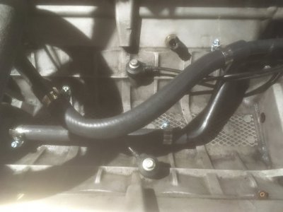

Finally got around to getting this one done. Used 5/8 and 3/4 sections of heater hose. This is the way ford shoulda done it.
I have to change my sig now. This one should never leak again and my rear main seal is still leak free after a couple months. 10 years, 230k miles, and no more spots on the drive way.

A couple feet of 5/8 and 3/4 inch sections of heater hose and 4 worm clamps. You will need to remove the intake manifold and fuel rails so buy some extra fuel injector o-rings in case any of them leak after reinstalling the fuel rails. Might want to get some intake manifold gaskets as well in case any of them rip when you pop off the intake manifold.
Before removing the existing stock heater coolant tube assembly put a bunch of paper towels in the lifter valley. When you pop it off you're going to lose a bunch of coolant.
