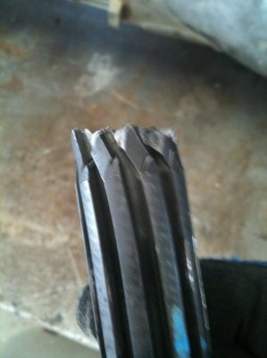

Well I snapped the input shaft. I'm going to need a new one and am thinking about going to an aluminum driveshaft while it's all apart. Anyone know a website where there are good ones for a good price? My car is lowered so that would effect which ones I can use wouldn't it?

I would recommend converting the input shaft to a hardened 26 spline one since it's going to need to be replaced. You would have to get a new clutch unless the company that makes yours can convert your existing one.
I've beat the piss out of mine at the track and it's holding up just fine.

When i put in the MGW shifter on the Saleen, i drove it hard for about two hours and heard the same snap, broken shaft and toasted Syncrhos were the diangosis. If the car had not been under warranty i woulda put a TR6060 in place of the 3650...

Did the shaft snapping destroy the synchros? I hadn't even thought of that. Shit.
