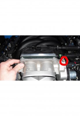

same here, except a TB cleaning made mine worse and made the idle higher. I found out that someone who worked on the car before i owned it had tightened the idle set screw, I unscrewed it about 1/2 to 3/4th of a turn and the idle immediately returned to the stock idle setting and the hanging rev went away.

Idle is electronically controlled. What did you adjust?

There is a set screw, that dark gray stud bolt at the top right hand side of the throttle body. I know its intended use is to get the correct/recommended voltage or resistance (i forget which it is) out of the sensor on the TB. You can and people do turn that screw when they have idle issues and dont know its intended use... however if you tighten that screw which opens the butterfly valves, your idle will rise and your idle will hang and slowly return to idle speed.
For future references:
PLEASE DO NOT EVER ADJUST THIS SCREW (on Ford throttle bodies).

Lito is correct, I should have been more specific and detailed... i do not recommend indiscriminately turning that screw.
Follow the instructions in the link below to check your Voltage read out from your TPS in order to tell if that bolt i mentioned above has been adjusted outside of factory specs.
http://www.americanmuscle.com/bbk-62mm-throttle-body-05gt-cust-install.html
No, you just simply don't do this with a stock TB, the screw is not serviceable, quite probably if you touch you will break it and unless you get very fancy, you lost your throttle body.
You can do that with the BBK but not with the stock one.

Will do, just for the record, I did this to my factory TB, nothing fancy at all, just followed the directions and my hanging revs and high idle issues were solved.
Attached is a image of the adjustment side of a stock S197 TB where you can clearly see the threaded bolt that is used to set the correct voltage on the TPS. I dont understand why Ford would say its not serviceable if in fact it was in my case...
You should play the lottery then, you may get the winning ticket with your luck.
All the people I've seen do this, broke the screw.
This comes set at manufacturing time, no need to mess with it.

AHHH i see your point... I can see how it could break, when i was adjusting mine, i did feel that the bolt wanted to bind, guess i am lucky lol
