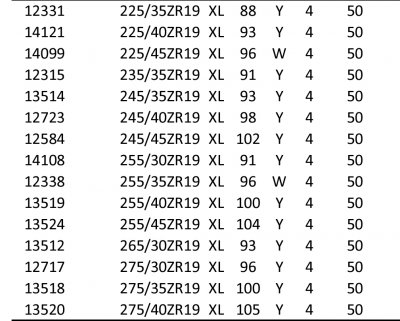

Here's the info I was able to download from their site on this specific tire. All are set at 50 psi currently.
Starting to think I just made a very expensive mistake.

Thanks for the information.
245/35-19 and 275/30-19 are both really small tires, and their small size actually does mean that they are "softer" in the vertical direction than proper-size tires are (OE sizes are typically 97 in SL or 101 in XL).
275/35-19 rear with 245/40-19 would be much better from a load capacity standpoint, though even those should probably get slight inflation pressure adjustments above "door-sticker" (roughly +1 psi rear, +3 psi front)
