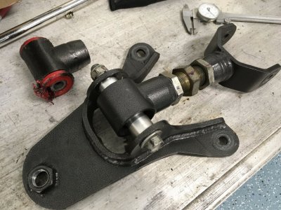

Changing from poly upper bushing to spherical bearing.
Busted the poly bushing in upper control arm a wait back decided with manual six speed, 410 gear and 700+ hp I should go to next step.
Also change upper arm bushing on rear end to the bushing used on 2014 GT 500, able to handle additional hp.
