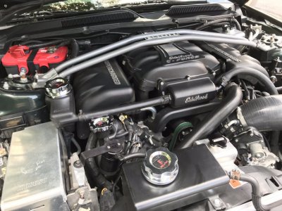

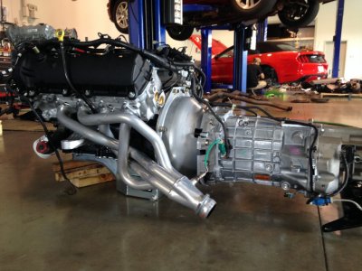

I've been running a B326 since 2017. Custom cams, ported heads, and E-Force blower. Day one I asked what oil they recommended and why. The answer .. 10W40 'dinosaur' oil. Said they found it maintained better oil pressure. I'm not an engine builder or seasoned mechanic, so I can't offer up a valid engineering explanation. I follow their recommendation and haven't had any issues. A quart of 10W40 is cheap. A failed engine is not. I change my own oil and filter .. often!
