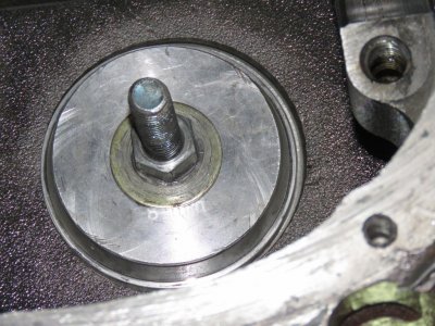

Quick questions for you guys. The new inner pinion bearing race (the bigger one) is being a stubborn mo-fo to pound into the axle flush. Would you or have you put the race in the freezer over night to get it to shrink just a little bit and not worry about it cracking if you still have to hammer on it a little bit?
A simple yes or hell no!!! will suffice.
I've got the bearing race driver kit and my 5 lb hammer and also I got some threaded rod and nuts to attempt pressing both inner and outer races at the same time like the manual says to do. Both methods are being a stubborn mo-fo.

I never froze it. Its not that tight. I tap it in with a brass drift. Just have to tap at different spots to walk it in evenly.

I found it easier to start the large outer race using some allthread and a couple of short steel bars. Final seating all the way to bottoming used the allthread through the race driver adapter. Checked all around with the thinnest feeler gauge (0.002") and all was good.
Make sure you lubricate the threads with some sort of grease, as you want as much of the torque you apply with the wrench to go into pulling the race home. Not beating up the threads.

Thanks guys. Thanks Norm. I'll try that method.
Edit - Thanks again. I got the races in. A little more light (might be time to get glasses) and a little more patience and little advice goes a long way.
