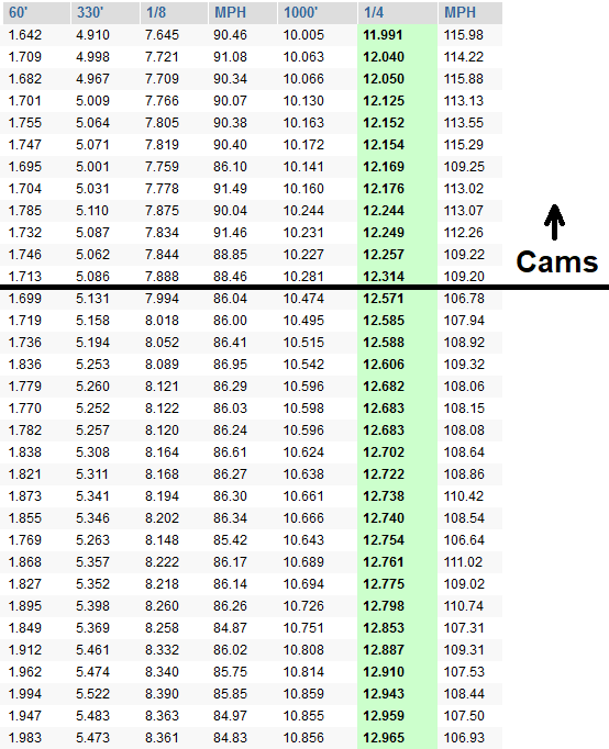

Cam's move the power band up, if anything they reduce low end and improve top end.
I was at 12.5's so before cams, now in the 12.1 to 12.2's on average with the once in a while 11.9 (depending on 60 foot)
Picked up around 35rwhp from the hot rod "sound cams".
I keep very meticulous records... ;)
