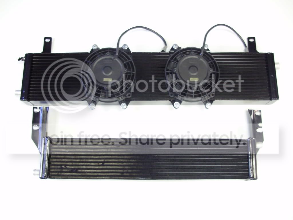

34 x 7 x 2 1/8" IF MY QUICK RESEARCH IS ACCURATE.
Sorry for yelling.
Can't be 34" wide. You can't fit that in there. It may be 34" with tanks, maybe. But not 34" of core width. That's HUGE. Our cores are 22.5" wide. And those are big.
And to compare core size with the other core sizes I have recorded I need the actual core dimensions, not the outside dimensions. As far as thickness goes I like to use tube size opposed to core thickness too. I core can measure 3" thick but only have 2.5" of tube. That makes a big difference when trying to make apples to apples comparisons.
Dual 10" fans...
Pentalab
Mar 5, 2013
5,507
1,327
If those are 10" fans, the HE would be 45" across..by almost 10" tall.
If they are 6" fans, then the HE would be aprx 27" wide x 5.75" tall.
