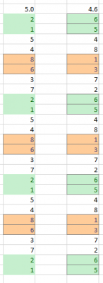

It looks like the 4.6 has one more same bank event than the 5.0.
Not possible. Not with any normal crossplane crank that has two rods per crankpin. Only the specific pairs of same-bank cylinder numbers change, and you still get one same-bank event per bank per two crankshaft revolutions (which alternates and is why if you get up close and midway between the exhaust pipe outlets and listen closely enough the rumble alternates right side - left side - right side - and so on ).

the coyote trucks use the same firing order as a 4.6.
No they don't.
The 2011 F150 owners manual has the firing order:
5.0L = 1-5-4-8-6-3-7-2
6.2L = 1-3-7-2-6-5-4-8
Coyote = 1-5-4-8-6-3-7-2 = Same as F150
302 HO/351W/4.6 2V/4.6 3V/4.6 4V = 1-3-7-2-6-5-4-8 351C, 351M and 400M too
All other Windors/429/460/FE's = 1-5-4-2-6-3-7-8
Flathead/Y-Block = 1-5-4-8-6-3-7-2 Same as Coyote
Yes I went and looked them all up. Don't post shit without confirming your right. Sloppy info is not cool.

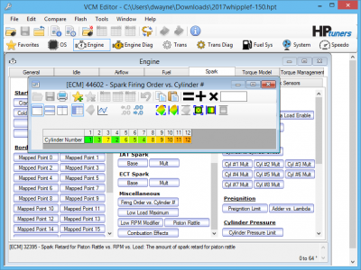

since you want to talk to me like im a fucking bitch, here you go a stock file from a 2015 f150
Wasn't talking to you like you're "a fucking bitch" but if you self identify as that.... that's your business. This board is pretty strong on having excellent and accurate tech info. That is what I was saying. If you make a statement as fact, be able to back it up. Expect to be challenged from time to time.
If you are wrong. Admit it and learn and move on. If your balls get busted for it. Own it. If you have thin skin, move along. This is not the board you're looking for.
Now after your post I decided to dig a little deeper. Because I like to learn and being challenged is a good thing. Found conflicting reports and claims. So I went to the horses mouth if you will.
In the 2015 F150 Owners Manual it says the 5.0 is still the same as the Mustang 5.0. But in the 2016 and 2017 and 2018 F150 Owners Manuals it says the 5.0 is now 1-3-7-2-6-5-4-8. Same as the 302 HO/351W/351C/351M/400M/4.6 2V/4.6 3V/4.6 4V.
Your 2015 file contradicts the Owners Manual. Maybe the change was midyear or maybe the manual wasn't updated.
But this is "news". I'd bet many here were not aware of this change. I wasn't. Coyote trucks have been around for about 8 years now and they are not all the same firing order as the Mustang 5.0. Had you said Ford changed the truck firing order in 2015 or 2016 to the old modular order, that would have been met with a different response.
Lighten up. Grow a thicker skin. Don't be "a fucking bitch" about things.
Neither of us was totally right or totally wrong.
