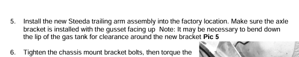

Steeda replied with a link to the instructions. Doesnt solve my problem, but at least I know the shop didnt read the instructions. Just a reminder to always double check any work you dont do yourself.
I should have time to get up under the car again and try to diagnose. I feel a little more at ease now that I know the bracket is seated and mounted correctly. Something is telling me its the spherical bearing on the axle side, its damn near 7 years old now and the car has been driven hard. Hoping its just the teflon liner has worn out. Keeping my fingers crossed thats all it is, easy replacement

When did you call Steeda? (guess you did just when I was posting lol)
If you haven't, that would be my first suggestion. Those guys are good and it's their part. They'll help you out.
I have their adjustable UCA bracket and it doesn't touch the tank. Forward hole is stock, rear hole is for increased angle.
I'd check the alignment of your gas tank to make sure it's in right. There's not really much wiggle room once it's properly nested, but occasionally I get mine being stubborn and have to wiggle it a bit to get it to sit straight.
You may also just need to bang down the edge of the tank seam to make clearance. But I'd chat with Steeda, first.
