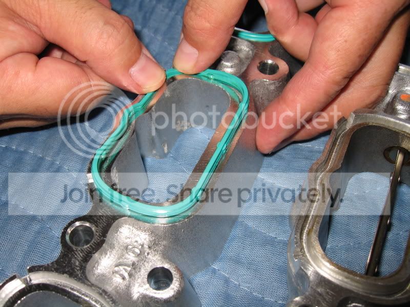

Thank you. The owner before me is the one that did most of the work. All I did was the headers because the o2 bung on the manifold stripped. I'm having to go through and redo what they did. What do you mean by delete plates?
Sent from my SM-N960U using Tapatalk
fdjizm
Drag Queen
Nov 29, 2009
19,534
343
NY/NJ
It gets rid of these that sit under your intake.
Ends up like this..
