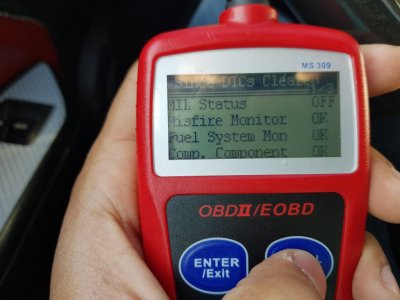

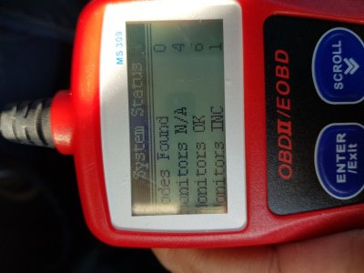

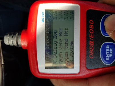

Is the o2 sensor supposed to read N/A with the spacer installed?
It reads Not ready before the drive cycle is done
but when the drive cycle completes, it's reads N/A
I only have one incomplete. Is this good enough to pass emissions?

It should read OK or incomplete. Where I'm at you can have one incomplete. I believe when it says N/A it is turned off.

It's really strange. When I start my car, it reads incomplete. After driving for 15 minutes, it reads N/A. Possibly due to bad spacers?

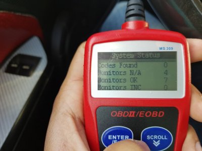

Figured out the problem. My O2 sensor spacers came with Mini cats in them and a cover. It seems that with those in place, the Rear O2 wasn't getting enough of a reading resulting it in reporting N/A since no post cat signals were being to the ECU. I removed the cap and mini cats, and bam it works like a charm. So far it's reading INC consistently. I'll try to finish a drive cycle tomorrow and hopefully everything works :) 20190725_001405.jpg
