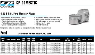

Trying to make a decision on pistons. I've heard good things about CP but I'm not sure what final compression ratio I should try to shoot for. I was looking at others and they were around 10cc dish, but CP doesn't have that sort of measurement.
Thoughts? Which piston in the attachment would get me closest to the 10cc dished.
