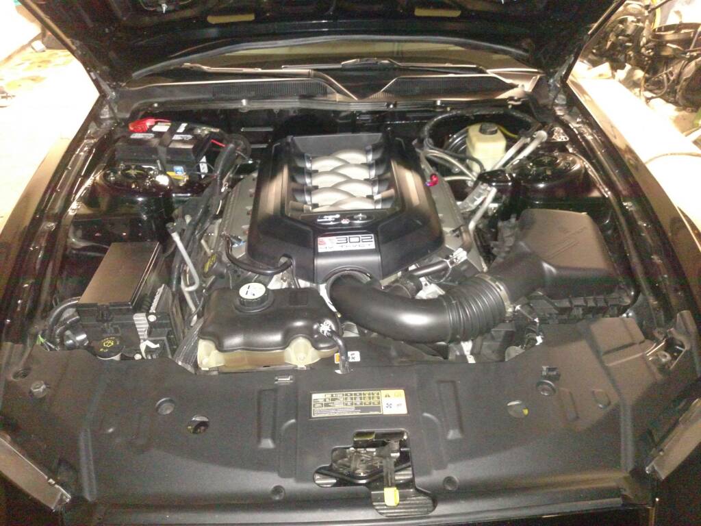

looking to do this swap myself. I recently picked up a coyote swapped 06 that has a write-up on here. Car came with the BMR tubular K frame, and a epas rack (not installed). Going to order the wiring harness which seems pretty straightforward except for the can bus wires.
I'm trying to wrap my head around hooking it to the control pack that runs the motor. How does it know how fast you're going at that point?
Or does the fact that those wires are hooked into the OBD2 port make it communicate speed to the rack. Also the speedometer works in the car but it's significantly off, would this affect the resistance for the rack?
Hoping that a dyno tuning will fix the speedo issue.
