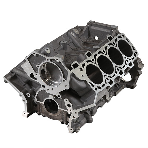

Gen 1 blocks tend to split the cylinder bore open in the Y-axis at large boost/power production levels.
Here is a Gen1/Gen 2 Typical block. Note lack of support at the top and bottom of the bore.
Here is the Gen 3 block. Note the added castings for bore strength.
That's because the gen 3 blocks are not sleeved. Gens 1 and 2 have sleeved bores.
You are implying the gen 3 is significantly stronger than 1 and 2. Not so.
No. I am not. I am not saying any such thing. Stronger? Yes. Significantly? Not necessarily.
I know this. When the 5.0 DOHC came out there were several documented cases of the cylinders blowing out of them. Yup holes right through the side of the bore into the water jackets. When the Gen 3 came along that all pretty much went away. Having a steel sleeve or not is neither a benefit or a detriment. Until it's time to rebuild anyway.
