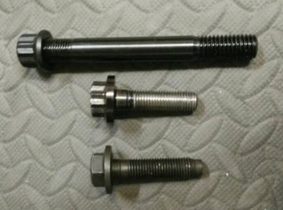

The ARP bolt will work... But I'd get the longest bolt you can put in there.

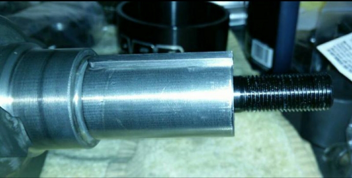

I actually had my crank snout drilled all the way back to the #1 main journal and threaded for a 5.25" long, 9/16" ARP stud. Had the keyway cut the full length of the snout too for square 3/16" tool-steel key instead of the wimpy woodruff style key that's in there from the factory. I realize that probably nobody is going to do those things just for a simple damper install. But I wanted to give y'all some ideas in case someone was doing a bigger build.
In case anybody wanted a comparison of the hardware on the Crank Stud Mod... On the bottom is the stock 12mm x 1.5 bolt... In the middle is the ARP bolt (Part # 156-2501), and on the top is the 9/16 x 5.25" stud (part # AQ5.250-1LB) and matching 9/16" ARP nut. (Part # AQN12-1)

I have the Arp 156-2501 myself. The mini Cooper cam bolt from arp isn't that much longer. Maybe 3 threads or so.
I can’t figure out why you would do this. Have you been throwing dampers off the crank?
Nope...I haven't... But I have seen photos of broken crank snouts, particularly on cars with a crank driven blower. Here's a great discussion about it: https://www.modularfords.com/threads/258205-Overcoming-the-Broken-Crank-Snout-Statistics
My mentality is that I have built a few engines and I don't want to build more... So, when you're that deep into a build it's "cheap insurance". Cost me about $150 for the machine work and hardware for that crank snout mod.
I chalk it up to the same reason people buy ARP studs instead of bolts, or billet oil pump gears, or billet timing chain guides. I also bought the Cobra Engineering timing chain dowel kit to increase those to M8 threads, and Manley Pro Billet rods instead of the forged H-Beam ones. (I have broken an H-beam rod though... So that one is justified).
I've never broken a headbolt, or rod bolt, or main bolt... But I always use ARP studs and ARP2000 rod bolts when doing a rebuild.
I've never broken an oil pump, but there are some stories out there of it happening, so I have billet gears in mine and the machined groove for the o-ring at the block surface.
I've never seen, nor heard, nor experienced a timing chain guide, or dowel breaking... But the billet ones definitely won't (and they look cool under the timing chain cover [emoji41]) .
When it comes to building an engine I tend to always believe it will be the last one I'm going to do... So I want to make it indestructible.... And then I usually find a way to destroy it. That's the game I suppose.

I ended up having Joey send me the longer crank bolt just for extra insurance. Many people using aftermarket cranks and ati balancers use the longer mini Cooper cam bolt. I have my engine at the machine shop right now so I can't check it but for the peace of mind I got the longer one.
