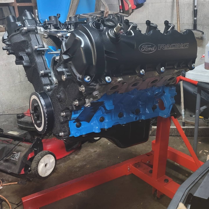

It will be a fun one. Putting this in as well.
