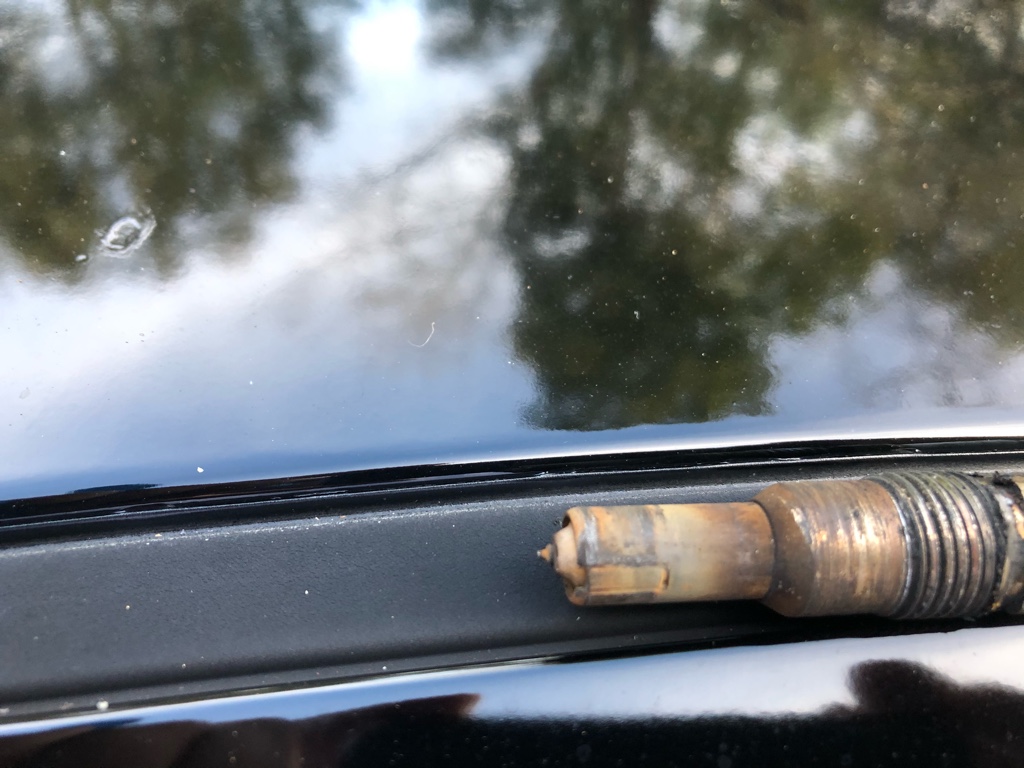

    Have any of you guys seen a bottom strap separate from the plug like this? This was cylinder #8 and I have 5000 miles on this plug.
    06 GT with a KB at 10lbs. I was driving normal during failure.

    Never seen nor heard of a ground strap separate from a plug like you've posted here. In fact, I've been running Autolite HT0 plugs on my supercharged "06" GT w/Saleen VI S/C and never had any issues with them, but then again, my car's max boost is rated at 7.5lbs. with 3.6" pulley. However, if the Autolite plug that separated is 5 years old and under? it's covered under Autolite's manufacturer warranty policy. Therefore you may want to contact Autolite and find out if they'll replace the plug under warranty :shrug:
  3. RED09GT
    RED09GT Senior Member S197 Team Member
    2,046
    203
    I've seen the groundstrap melt but if this happened during normal driving, I'd say this is a manufacturing defect.

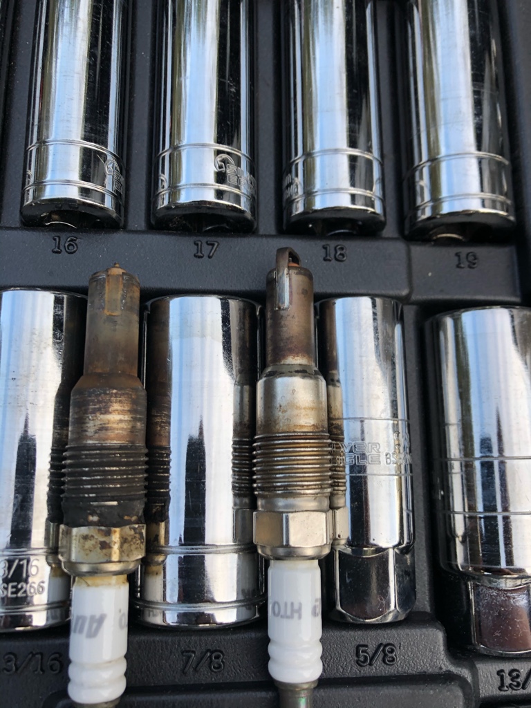

    500 miles after the plugs were installed my # 1 cylinder had codes for a misfire. I pulled and replaced the plug. Attached is a pic of the #1 and 8 cylinder plugs. It’s making me wonder if something else is going on in the block.

  15. MrBhp
    MrBhp Member
    367
    192
    I would be less concerned with the plug strap and very concerned with the obvious detonation occurring from a lean condition. Unless I'm seeing it wrong, that piston has already failed. It's going to be catastrophic failure soon. Have you done any data logging recently?

  18. Rick Simons
    Rick Simons Member
    101
    20
    Yeah after seeing that plug with the strap blown off, I'm going with detonation. It's a very destructive process!

    After reading over some of the recent posts, I tend to agree it was detonation which caused the plug strap to blow off rather than from a manufacturer defect with the HT0 spark plug that was previously suspected from a previous post in which I had submitted earlier in the thread.
  20. JeremyH
    JeremyH 3V Fuel Guru S197 Team Member
    20,801
    161
    Strap issues is the symptom. Root problem was the detonation which will melt and break any plug.
