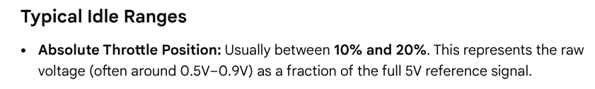

throttle position is always above 12%
That's normal when your foot is off the gas pedal.
