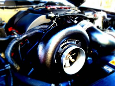

With my tial q and the filter instead of airbox you can hear it pretty good. But not near as loud as the straight cut prochargers. Those thing are super loud

dynoed car today.
paxton 2200sl with 3.8, stock intake manifold and exhaust manifolds, lethal 3" off road x, id1000, kb bap, jlt cai
first pull was with jlt 628 hp and 500 tq
second pull we removed the jlt 639 hp and 515 tq
