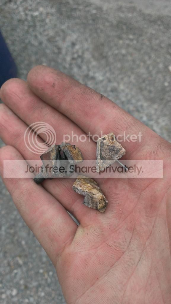

In other news, the original battery cable with the wedges is NO MORE. Lol.
I hated that stupid wedge anyways. The reason is broke is that the positive magically came loose AGAIN after being pretty tight that last time I tightened it. I literally gave it two more turns to try to tighten it back up and the wedge broke. I'm not too heartbroken about it, I drilled a hole through each side and am now using a bolt and nut. Perfect and problem solved.
