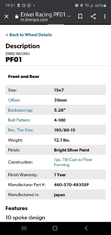

One of the photos below is from Tire Rack's website.... Says 12.1 pounds... (What I realized after going back to check was that was for the 15x7 wheel) ... Yes, I admit, an unreasonable size for an S197 Mustang, but not "absurdly small" like on a Miata or Mini Cooper
In my defense, I was hastily trying to post a reply to the OP about "light wheels". As you pointed out... Enkei PF01's are some of the lightest "racing" wheels out there and at a pretty reasonable price.

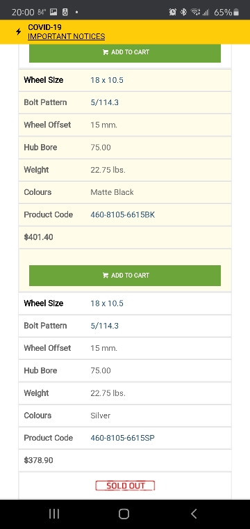

1010Tires website (pic below) has the spec for the Enkei 18 x 10.5 PFO1 at 22.75 pounds... Heavier than the 18.5 pounds shown in your first pic for a very similar size (18x10) but still pretty darn light... And at ~$400 a wheel / ~$1200 a set.
Sent from my SM-N975U using Tapatalk
Probably won't be much difference in weight, but you really need to be looking at offsets more in the +35 to +40 range.
I hope the 1010 people aren't listing those Product Codes for S197 Mustangs - 10.5" at +15 offset would poke badly on both ends of an S197, think offroad-Jeep bad.
