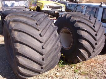

I took Vorshlag's advice and picked up a decent set of used ultra-wide tires.. 18x48's I believe... Gonna have to flair my fenders I think.
Sent from my SM-N975U using Tapatalk
Just add some negative camber till they clear! And dont forget the LS swap to complete the transformation.

I'm going to fill them with helium so Vorshlag can't talk crap about how heavy they are... Gonna fly by him on the track like the Jetson's.
Correction... I Googled what gas is lighter than helium so Vorshlag didn't correct me... I'm now going to fill the tires with Hydrogen... Just gotta be mindful of any heat.

Wont matter what gas you fill them with. A lighter than air gas may reduce static weight, but has zero effect on the mass of the wheel/tire.
