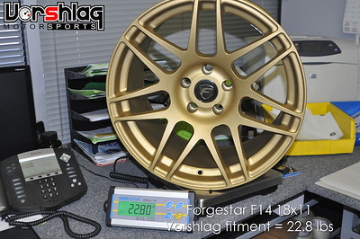

Late model Mustangs like the S197 benefit more from WIDER wheels than narrow/smaller than stock. Cornering, accelerating, braking - all do better with more tire. And to support more tire width, you need wheel width. 18x11" with 315/30/18 tires (above) or 19x11" with 305/30/19 are the common choices.
As for realistic weights for these wider wheels, the 18x11" F14 above is 22.8 pounds and the 19x11" F14 is 26.7 pounds. That's pretty common for a flow formed wheel. Pure cast wheels will weigh more (by up to 10 pounds) for 2/3rds the price and forged monoblock wheels will weight 1-3 pounds lighter, per wheel, with equivalent strength (for 2x or 3x the price).

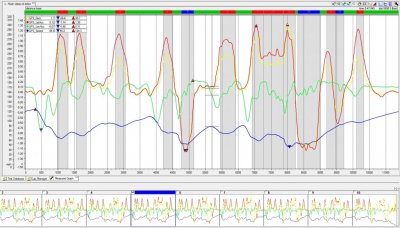

What I post does have some actual observations behind them. It's not just from books and SAE papers. I do notice things. But feel free to post comparative curves of various aspects of handling for tires mounted on measuring vs T&RA max width wheels.
I don't do as many pictures as Terry does either. MPSS tires. OE springs.

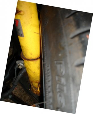

Im having a hard time believing a 305 on 11" wheel fits up front.
You can probably hold the amount of 'poke' down to only a few mm more than this. That's with something like -1.9° to maybe -2.0° camber.
Even with 26" tall 305s, it's probably not going to tolerate much lowering, though.
I'm using all of the strut side room, just short of getting a rub. Might want an extra mm or two with 305s.

This isn't theoretical, we have done this on many many cars over decades, with lots of lap time data and wins to show for it. Wider tire always is faster. ALWAYS. But hey, if you wanna stay slower, stick with Skinny Tire Syndrome. I'm not going to stop you. :)
Well, I guess if you lived under a rock and never went to track events you might not see these things? But we spec'd and built the first 18x11" wheels that fit under stock fenders of an S197 in 2012. Many many hundreds of sets sold of these since. We even ran 18x12's in the back, but there were some compromises to do that, and we almost never sold wheels this way.
There were no tricks up front - just running enough camber (we didn't even cut our strut towers) and adjusting the strut-to-spindle adjustment just right, to keep the wheel as close to the strut without rubbing as possible.

If LAP TIMES matter to you, then wider wheels and tires are PROVEN to be better, even in HPDE. The 19x11" wheel and 305mm tire package (above left) was notably faster on our customers S197, who had 18x10" wheels and 285mm tires before (above right). He logged every lap time and had data to prove this, not just "feelings".
