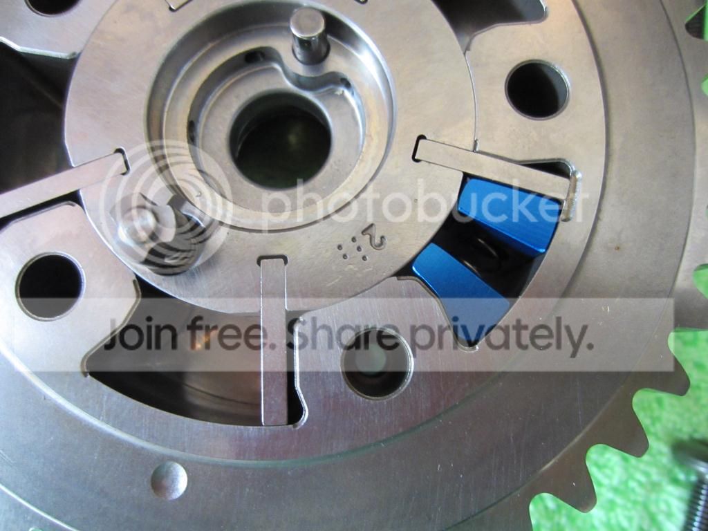

I think the reason the spring is in there is to keep the limiter from just flying around. The cam phaser moves on its own due to oil pressure, and the limiters/lockouts just prevent it from moving. That teeny, tiny spring would never be able to combat the massive spring in the phaser.
See how the lockout takes up the whole slot in the phaser?
The limiter would take up less space, and would be free to rattle around in the phaser (not that I think that would be an issue). The little spring is probably just there to keep tension so the two halves aren't just vibrating around in the phaser.
(Bad picture, but the only one I could find of them installed)

Had the Limiters in my build as they came with the FRPP heads. Did not work for me as one of the springs broke. Went with the Livernois Lockouts. Here is an install pick of a Limiter. As far as I know they were installed correctly as I sent pictures to FRPP and they said I was good to go. My experience for what is is worth.

Ok this may be a stupid question but how do you know which slot to put the limiters or lockouts?
I simply copied what Scott did in his build thread because he's a perfectionist and I'm sure he spent lots of time researching that question. He put his in the slot next to the number 2 engraved in the phaser so I did the same.
Hahahah, good answer! Ok I did send pictures to Ford Racing Tech Support and received confirmation they were installed correctly. However, I have absolutely no explanation for finding the broken limiter spring in one of the phaser when it was disassembled.
