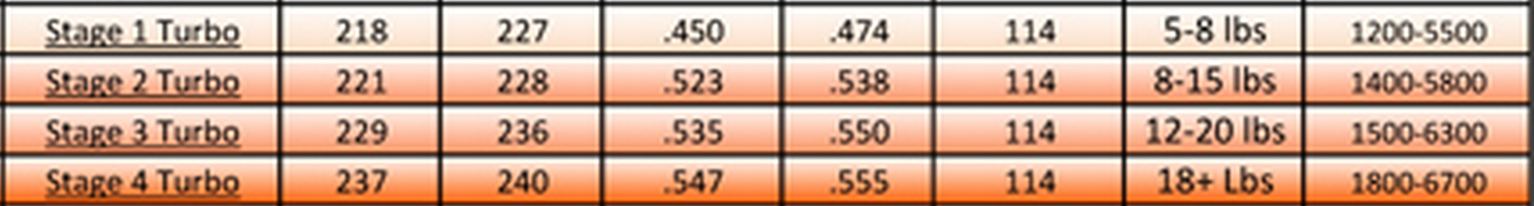

Livernois rep: What's the difference between your NA stage 2 cams and Comp 127500? The published specs are the same. I'd guess that the icl is at 102 also. Do your stage 2 cams have the same icl? How about the ramp rates, are they the same?
BTW I'm running a set of special grind cams that are Livernois branded but they were made by Comp as indicated on the cam card. Does Comp still grind the Livernois cams?
