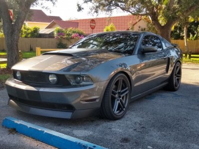

I have a 2010 mustang GT. Was on a tight budget so I couldn't spend a crazy amount of money on the lowering of my car and change of the rims and tires. I used Ford performance k lowering springs lowering the car an inch and a half all the way around. unfortunately didn't change my front struts but changed my rear shocks and bumper jounces. I had 18 by 8 bullet rims on it and changed up to 20 by 9.5 on the front and 20 x 10 velgen rims on the back. Tires are 275/35 on front and 295/35 rear. As for the handling... I can tell you anytime you lower your car and change to bigger rims and profile tires your ride is going to suffer. a rough road I personally feel every bump on the road. car handles way better you can dart in and out of turns breaking is better as well. Car sits nearly level. also anytime you lower your car you're going to need a adjustable sway bar because the rear end will push out on the driver side.

I'll post a pic of the car soon. I was also going to say that my springs are progressive. If you use linear springs they are meant more for performance and your ride quality will suffer more as progressive springs will give you a better ride quality. Yea, some may not like 20's but they do make the car look more aggressive and fill the fender wells really nice when lowered. I posted a pic of mine.
