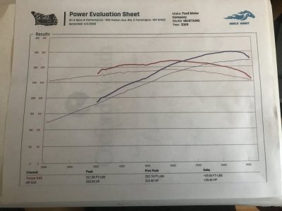

Yes I do have a printout of it but I didn't initially post it due to my tuner making a mistake & putting it w\ the final dyno run on 12-27-19 instead of w\ the 10-8-19 dyno run which would've given a false gain comparison & created some confusion (the 12-27-19 dyno run is when we made corrections to tune to fix the false misfire data...raised the misfire monitor min enable ECT setting from the OEM 20*F to 80*F to allow the crankshaft to warm up some more to smooth out the firing pulses to the CKP sensor before enabling the misfire monitor & reset the spark timing retard scale for COT protection to help w\ the CKP pulses...later resolved by removal of bad dielectric grease from COP boots\springs & installation of new MC plugs to stop the actual misfires noted on cold starts which drove the COT protection....saw all on tuner's datalog during a cold start & in which we saw the lost HP\TQ on low end.... -6.98 HP\-16.00 TQ @ 324.50 HP\292.15 TQ vs the 10-8-19 final run @ 331.48 HP\308.15 TQ due to sluggish VCT response below 4500 RPM's....which was later found to be from a broken cam follower on 1 intake valve on #7 cyl & some metal trash from oil filter changeouts lodged in lower screen of the B2 VCT solenoid). I didn't get a copy of this 12-27-19 dyno run at that time & had asked my tuner to print 1 out for me but he put the final 4-2-20 run w\ this 12-27-19 run by mistake which inflates the total HP\TQ gains higher than what they really are so I decided not to post it.
The 4-2-20 printout I posted has the actual 10-8-19 final run curve compared w\ the 4-2-20 run curve shown on it (the 348.96 HP\321.43 TQ) that was run just before the final 4-2-20 run (352.95 HP\321.98 TQ) was made which is a more accurate comparison as these 2 4-2-20 run HP\TQ curves are virtually identical curves & overlay each other pretty well except for the slight peak TQ gain & at the top end where the slightly higher TQ curve hangs in for another 100 RPM's or so to allow the peak HP curve to move up the slope the extra 3.99 HP before the PCM pulled spark timing due to the excessive ECT from the extra loading from pushing her to redline after a 20 min cooldown (tuner had let up on the prior run before redline for the same reason as this was the 1st time he saw this happen) for a more accurate total +21.47 HP/+13.83 TQ peak to peak gain vs the 10-8-19 final run of 331.48 HP\308.15 TQ instead of the false +28.46 HP\+29.83 TQ peak to peak gains on the other printout against the 12-27-19 final run. The 10-8-19 final run was the best we ever saw w\ the Lunati VooDoo #21270700 cams using the same FBO's until this 4-2-20 session....the better mid\top end HP\TQ gains were mostly due to improved airflow thru the Ford Performance 62mm TB's better porting work vs the BBK #1763 62mm TB which also has a lot to do w\ the ECT rise on the top end that caused the PCM to start pulling spark timing at the top on both runs as we never saw this happen on any prior WOT runs before these last 2 runs during this 4-2-20 session so I know that she is now as fully optimized as she's gonna get w\ these cams w\o FI (which I'm definitely not gonna do now w\ this engine since all the issues I've went thru earlier + the high mileage). These results also show that this Ford Performance Bullitt 85mm CAI will flow better than thought prior as well...even w\ a cone filter dust sock installed AND w\o ram air effect (the entire intake tract is now composed of all Ford Performance components & is now also fully verified to be leak free from all the vacuum leak repairs from all the smoke testing done so all intake airflow is coming thru the MAF sensor section now.....which may also be more of a contributing factor now as well that I didn't think about before as PCM will better calculate WOT load% & up spark timing on a higher lbs\sec MAF readout) so w\ the addition of the FP 62mm TB the FP Intake Manifold's upper end airflow capabilities can be exploited even more which says a LOT of the Lunati's cam lobe design profile used w\ this VooDoo #21270700 camshaft set to move air when paired up w\ the Kooks 1 5\8" LT headers, Kooks Catted Mid Pipe & Pypes Super Bomb Mid Muffler catback exhaust system's ability to scavenge\exhaust it....thru OEM non-ported cylinder heads....but sounds almost like OEM cams are still installed at idle...…almost.
Just for reference, this is Lunati's base VooDoo cam profile design for the Ford 4.6L\5.4L 3V Modular engines. They have 11 more to choose from.....
So yeah I'm a happy camper & am fully satisfied w\ where all is at now engine wise. I have to say also that she looks damn good to me when I raise the bonnet now.....
PS--Here is the other 4-2-20 dyno sheet that has the final numbers on it:

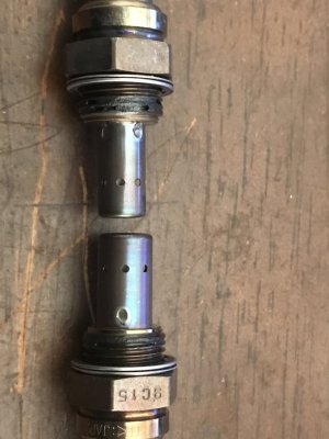

FYI.....
After the tuning session & subsequent drive cycle performed done to get all squared back up & fully operational (OBDII IM Readiness code green) I got out my trusty Foxwell NT301 scan tool to check up on all (was bored so I did this to pass the time) & I found that we had a pending DTC code situation in the PCM (code yellow).....checked the pending codes & found 2 of them...P0139 (B1S2 O2 Sensor Circuit Slow to Respond) & P0159 (B2S2 O2 Sensor Circuit Slow to Respond). These are saying that both rear O2 sensors (the post cat sensors) are not responding to O2 sample content changes fast enough (for reference both of these sensors are mounted in BDG 90* CEL Eliminators & have been in these for almost 2 yrs to rectify the P0420\P0430 Cat Efficiency DTC codes I was getting when I was running the Bama tunes at that time prior any dyno tuning by my current tuner) so I looked at the Mode 6 Component Self Check Test results for all O2 sensors to see where the failures were occurring.
The test results showed that both O2 sensors were failed due to the lean-to-rich switch rate being BELOW the min allowed tolerance but the rich-to-lean switch rates were right at\just above the min allowed tolerance as well. This data is conclusively showing that since the repair work\retune the O2 sampling content% flowing into the BDG's has changed (O2 content output is more static than it was prior) which is a sign that the Kooks cats have improved operations now (much less HC pass thru substrate...) but also is a sign that these BDG eliminators are gonna become an issue now causing essentially false rear O2 sensor DTC's so I had to remove them.
At this time I also remembered the initial data that I had gathered back then (was using the "new" Ford OEM replacement O2 sensors which are BOSCH #15717 O2 sensors....a dedicated pre-cat O2 sensor design that is also shown by Ford to be used for dedicated post-cat O2 sensor usage) may have been skewed by the O2 sensors I had installed (the original S197 O2 sensor design for Ford at manufacture called for a dedicated front O2 sensor\dedicated rear O2 sensor setup)...which means that the O2 sensor elements use a different sized shield over them. This shield also determines the amount of exhaust sample content allowed around the element as shown in this picture of the NTK's I have currently installed:
IMG_0084.JPG The front sensor is the lower one, the rear sensor is the upper one. So even if the rest of the O2 sensors are identical they will not react the same...the rear sensor is actually less sensitive than the front sensor to O2 exhaust content so if 2 of the same design were used as both front\rear O2 sensors this would throw off the PCM in determining cat efficiency (the coding inside the PCM) in the 1st place. The front sensor's amplitude performance is just as important as well as the rear sensor's rich-to-lean & lean-to-rich performance in determining cat efficiency as the coding used in the PCM is predicated on this type of O2 sensor's design performance input to properly do it's thing w\ fueling but also cat efficiency calc's.
So I ordered a couple of the 96-04 Mustang Cobra MIL Harnesses (which are set up to work w\ the very same NTK 22060\22500 O2 sensors that were used in 05-10 S197's as these were also the very same O2 sensors used w\ the 96-04 4.6L Modulars) then got under car & pulled the BDG 90* CEL Eliminators, put the NTK 22500's back in the exhaust piping then before I plugged the Cobra MIL's in I ran tests w\ the NTK's themselves & noted thru watching the voltage readouts the cat's operation had indeed gotten better. I could see the cats actually light off once they got hot enough (the rear O2 sensor's voltage switching rate narrowed up & stayed between .785\.675 once RPM's were raised to 2,500 & cat temps exceeded 950*F then essentially stayed in this range w\ the occasional drop to .120\.130 while back at idle. Cat efficiency is tested by PCM between 1,300-2,500 RPM's which is normal driving range & why you raise the RPM's into this range to check the O2 sensor voltage response & the switching ratio between the front & rear O2 sensors) so it appears that none of these CEL eliminators are needed anymore but I then installed them anyway to see what they will do to the rear O2 sensor's voltage signal. After doing this then restarting the car & running the same tests the voltage signal change that I could see was that they reduced the amount of signal rise (at same speed they crested at .587\.465 & took longer to drop back down to the same .125\.130 at idle so in essence a shorter peak rise w\ a longer time to drop so a lower, slower sine wave oscillation pattern) which the PCM readily accepted this pattern as good (came out to the exact same front\rear cat switch ratio as w\ the BDG's eliminators but w\ more lean-to-rich & rich-to-lean rear O2 sensor movement which put them in the .34\.28 for B1S2-min was .07, .31\.22 for B2S2-min was .12 for B1 cat @ .191, B2 cat @ .238 which is passing OBDII for the O2 sensors AND the cat's efficiency) so the PCM actually stopped monitoring the cats at that time (the cat STFT & efficiency% is removed from the live data only leaving the O2 sensor voltages to monitor) as it determined that they are operating just fine....which in actuality they really were. So I cleaned up the install, put her back on the ground & drove the car about 18 mi thru stop & go traffic to see if all stayed clean. Got no MIL so I parked her for the rest of the day.
I then retested for this the next day from a full cold start to see if any thing showed to change. Monitored thru to full hot & performed the exact same test procedure as done prior…..and got the exact same behavioral results from the PCM as described above!
So this is now also resolved......and all is almost back to stock configuration!

FYI.....
View attachment 72390 The front sensor is the lower one, the rear sensor is the upper one. So even if the rest of the O2 sensors are identical they will not react the same...the rear sensor is actually less sensitive than the front sensor to O2 exhaust content so if 2 of the same design were used as both front\rear O2 sensors this would throw off the PCM in determining cat efficiency (the coding inside the PCM) in the 1st place. The front sensor's amplitude performance is just as important as well as the rear sensor's rich-to-lean & lean-to-rich performance in determining cat efficiency as the coding used in the PCM is predicated on this type of O2 sensor's design performance input to properly do it's thing w\ fueling but also cat efficiency calc's.

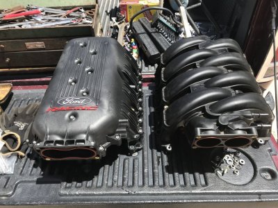

Just thought I'd post this in this thread instead of starting a new one.......................
For all those that are running a Ford Performance Intake Manifold I think I've found a design issue in it that can cause some issues w\ OBDII certification passage concerning cats that I didn't think about\know of when I bought it. Here is a picture of this manifold beside the OEM intake:
Please note on the stock unit the casting just behind the TB mount flange then look at the FPIM unit.....that casting is the EVAP plenum-isolated port routing thru the manifold from the EVAP CPV connection to the lower port located at the bottom, rear of the TB mount flange to promote even EVAP vapor\unmetered air distribution into the incoming metered air stream to promote stable O2 sensor feedback across both banks (which the PCM uses the STFT readouts from pre-cat O2 sensors to determine the amount of free O2 sent into the exhaust ahead of the cats as well as for engine fueling control). This is important for the PCM to do as accurate a Catalyst Efficiency check as can be done while the PCM is also performing EVAP canister purging cycles.
The FPIM's EVAP connection is not ported thus isolated to this same area behind the TB mount, it is open ended into the side of the manifold's open plenum right in line w\ cyls #1 & #2 intake runner on B1 and in close proximity to cyls #5 & #6 intake runner on B2 as the PCV return connection is in both manifolds. The PCV side isn't a problem as this system uses metered MAF air (as long as there aren't any leaks in the PCV system proper to allow unmetered air in thru it) but there'll be unmetered air along w\ trapped canister fuel vapors passing thru the EVAP CPV into the intake manifold as well as w\ the OEM intake the open plenum collection area is located below the intake cyl runner flow laminators to facilitate mixing\settling before air entry into these runners as opposed to the FPIM intake's open plenum area\intake cyl runners. I verified this configuration difference recently when this specific OEM manifold design caught my attention watching a YouTube video of a '07 FR500S production race car & from reviewing my CE monitoring test results I did on my car May\June of last yr then witnessing the LTFT's fluctuating while my car was idling instead of staying relative stable once learned & I had recorded all this on the tests but didn't register w\ me at that time. My test data initially showed both cats passing the OBDII Component Checks for Catalyst Efficiency but over time slowly showed degradation & failed but only 1 cat failed then upon a KAM reset to verify pattern (which if cats were actually bad they should have failed on the 1st drive cycle--pending DTC) then set the permanent fail P0430 DTC w\ the MIL on the 2nd drive cycle but they didn't do that....they both passed on the 1st drive cycle as they did during the 1st test period and it took several days for them to fail again...in the exact same pattern AND w\ the exact same failed CE ratio result on the exact same B2 cat which in retrospect is rather odd & not the expected normal failure pattern.
Now as far as engine fueling control goes this doesn't cause an issue w\ the FPIM installed and could be deemed fairly routine STFT\LTFT behavior BUT the unmetered EVAP air entry from EVAP purge cycling while the PCM cat CE checks are also running unevenly entering specific cylinders across engine banks can cause excessive O2 amounts getting sent into the cats causing a potential premature cat CE failure result (the PCM actually does this intentionally when it is testing the 2 rear O2 sensors for Component Readiness monitoring checks) simply due to the PCM not being able to perform independent cyl fuel control based on independent cyl O2 exhaust monitoring. This manifold was evidently designed by Ford w\ the main focus for racing purposes but not necessarily w\ the OBDII cat CE testing in mind (IOW's...low speed stop & go daily driving where all PCM cat CE monitoring takes place as well as EVAP canister purging) as the OEM intake manifold was. Now if a good, high quality & properly sized cat that conforms to OBDII compliant monitoring stds is used I'm sure that it can\will overcome this quirk from this small EVAP routing design change between the 2 intake manifolds & operate just fine but this is 1 of the issues concerning the use of aftermarket hi flow race cats w\ OBDII monitoring & why they're so hit or miss w\ cat CE.....
I'm gonna go a different route as it should kill 2 birds w\ 1 stone throw....so to speak.
I've ordered a used OEM intake for a '08 GT 4.6L engine (intentional for the metal removeable IMRC runner controls) along w\ Steeda CMDP's (gonna keep the OEM IMRC's functional if I'm forced to reinstall them in the future but these CMCV's are an OEM non emissions specific engine device\component as their specific design purpose is for engine performance enhancement, not emissions thus should be Ok to legally disable in tune...they're not in the same situation as the VCT is for example since the PCM uses VCT for EGR purposes to control NOx emissions when engine is under light load% operating conditions thus has an emissions specific task as well as for performance...they're not OBDII monitored as this is written into the tune software but this issue is 1 of a few others in which makes the PCM performance tuning an issue outside of the OBDII monitors w\ the EPA concerning emissions compliance...they can be limited if proof of emissions compliance is provided but can't be legally locked out\disabled unless an EPA\CARB approved tune is used w\ the phaser lockouts....ala Livernois) & Steeda heat blanket insulation to cover the bottom of this intake's plenum area to promote cooler air intake charge thru it by arresting the heat soak from the engine valley between the cyl heads to replace the FPIM then check all this again to see if the Kooks race cats now will permanently pass the OBDII CE monitor tests.
These intakes are not the easiest to get ahold of in good used condition for a decent price (new is $609.95 + tax off www.Ford.parts.com) as 1 might appear to think due to the age of this S197 platform (took a while but found 1 for $190.00 + tax & shipping from LKQ....in like new condition) & this 4.6L 3V V8's service longevity as most won't part out a complete engine unless it's totally junked out but these don't sit in junkyards very long so is a good testament to this '05-'10 S197 platform's popularity\service record.
Once I get all the work done & tests run I'll post the results.......
Just putting this out here for the information..........

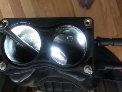

This is an attempted picture of this EVAP port outlet in OEM IM behind the center bridge in backside of TB mounting flange where the EVAP vapors\unmetered air enters the intake plenum area below the intake runners. The light reflection in the center of picture is off the port outlet (best I could do w\ what I got & knowledge of using MS Photo software).
This picture is to show that this port is isolated from the plenum from the EVAP CPV connection (upper connection) to the backside of the center section of TB mounting flange.
This is what I am referring to in earlier post that is not present in the FPIM....and it will affect the O2 sensor feedback fidelity to the PCM when the EVAP CPV is cycling if the EVAP discharge port isn't located in the incoming airstream as shown here in relation the ITR's to promote proper, more even EVAP discharge into all 8 intake runners when it cycles so the actual A\F ratio mix in EACH cylinder is more accurately reflected thru the O2 sensor feedback to the PCM (the sample read\calc'd by the PCM from the O2 sensor is an accurate extrapolation of even distribution of all cylinders in the cylinder banks).
This is important for proper PCM O2 sensor feedback OBDII free% O2 measurement control into a cat for Catalyst Efficiency monitoring due to the PCM's STFT % w\ the FPIM is actually being more driven by the front 2 cylinders in each cylinder bank where the majority of the EVAP discharge is being ingested thru but fuel control is metered to ALL cylinders in the bank equally off the feedback results.....fuel control is actually making up more (pulling fuel away to make up for the EVAP vapors) for the 2 front cylinders (where the majority of this vapor is going thru due to the location of the EVAP port being located in the side of the FPIM's plenum pointing directly into #1, #2 & closest to #5, #6 intake runner entries) which can leave the 2 rear cylinder's actual fueling in each bank somewhat out of adjustment (usually leaner in proportion to the density of the EVAP fuel vapor\unmetered air) compared to the 2 front cylinders so can throw off the O2 sensor feedback loop's overall accuracy (example of STFT reading used to determine free O2 in exhaust: PCM calc's say STFT is +2% free O2 when the actual may be +4% to +6% free O2 because an O2 sensor isn't reading the entire exhaust output content but is only sampling a small amount of it so can miss a lot as it can only react to the sample that has come into contact w\ the O2 sensor's element inside it's shielding & the PCM can only extrapolate to the 2 rear cylinder's A\R mix in each bank to match the calc's made from what it knows thru the O2 sensor feedback sample it got). I had picked all this up in a couple of FORScan datalogs logging STFT's last year that definately showed the PCM cycling the EVAP CPV but it didn't click until recently this year after I noted the outside OEM IM casting design layout in a video & figured out what was beneath it.....it never dawned on me when I took the picture of the FPIM beside the OEM IM on the tail gate of my truck during the FPIM install....some 2 1\2 yrs ago!
This issue--as small as it appears--can make it much harder for a cat to pass under an OBDII Catalyst Efficiency monitor w\ this FPIM......especially w\ hi flow race cats (as my currently installed Kooks Catted Midpipe has) that are of a 2-way internal design instead of a 3-way internal design (what the cerium brick is in there to account for w\ a 3-way cat design but can hurt some cheaply loaded 3-way cats as well) & is why I'm pulling my FPIM off my Stang & replacing it w\ an '08 OEM IM w\ Steeda CMDP's since this car isn't gonna be used primarily for racing so to me the O2 sensor feedback fidelity for good OBDII CE operation\compliance is far more important than the FPIM is (OEM IM will most likely shift the current HP\TQ curves to left of current peaks which should improve drivability & low end response vs current w\o a large hit to top end output). So another dyno session is coming in the near future as well.
I can't wait to see the results.
My car is entirely street driven and the engine operates mostly in the 1500-3000rpm range, with only occasional bursts to 6000+rpm. For that reason I was never tempted to swap in an FRPP intake manifold and kept my OEM unit with CMCVs. Though those high rpm bursts are addictive, it's also fun to use the strong lower rpm torque especially on the highway, where overtaking in 5th gear (stock 3.55 axle gears) is totally effortless and the throttle response is instantaneous. That torque also helps highway cruise gas mileage.

Yeah Dino I'm doing it..... A little backdrop...........
This all got going right after I retired & bought her....had a couple of coworkers who were fellow gearheads, 1 of which was into drag racing & this coworker was the 1 who was the little "devil" sitting on my left shoulder. My original intent was to build her for all round purpose leaning on drag racing since I found out that there was a NHRA-sanctioned track in Albuquerque thus the component choices....not really wanting to be very competitive but wanting to be decent performing & have fun but w\ a focus of a potential FI application down the road (centri SC at the time) thus the 3.73 gear choice as well as the FPIM & cams.
After a while over time I realized that that wasn't the direction I really wanted to go w\ this particular S197 (Glass Roof Edition) plus I noted how a rear suspension setup that had drag racing focus didn't have the type of compliant ride I really liked (I like smooth but nimble, crisp response for touring....more in corner carver area) so I started reversing course but also looked to take advantage of the OEM development across the S197's production run to use better OEM designed parts from the later MY's to upgrade my MY to get a 2-fer....maintain OEM ride compliance but improve overall handling performance at the same time by targeting OEM SVT & some specific Ford Performance suspension parts.
The FPIM wasn't on my radar to get swapped out until after I had ran all the tests last year to see if I could get the Kooks hi flow race cats to pass OBDII CE....got very close to actually pulling it off. Then I realized the EVAP routing in the FPIM has a negative effect on OBDII CE but I also didn't want the CMCV's either so now you know the rest............
I know I could have gotten around this issue w\ the FPIM just by installing the PROPER EPA cert, OBDII compliant cats oversized to account for the performance tuning & manifold quirk but since my target has changed for the car I don't really need as much top end power & the fix for the OBDII CE is to reinstall the OEM IM so out goes the FPIM & in goes an '08 OEM w\ the removeable CMCV's so I can use Steeda CMDP's & save the OEM CMCV's to reinstall if I'm forced to do so to comply w\ Fed EPA OBDII in the tune (which I'm not so sure this will matter since these aren't listed under IM Readiness OBDII monitors...the emissions monitors) so we'll find this out down the road at a later time so after this no more IM changes as I've also ruled out any FI installations going forward as I simply don't NEED it to enjoy her.
As for the dyno run, I'm even more curious as to what the effects of the increased cooling capacity I have installed last year is gonna have as well as this IM so the 1st runs I'm gonna have my tuner to do w\ the tune as it is currently to get an apples to apples comparison between the 2 IM's (the only changes made engine-wise) then make any tweaks needed to make the most out of the longer intake runners. I have a gut feeling that she's gonna surprise me on the amount of top end HP\TQ loss....meaning less than what I may think it's gonna lose but I'm also definately gonna be interested in how much the low end hopefully improves in relation to how the mid range responds as well.
As usual I'll post up w\ the results.
PS--1 thing I found out before doing this is you can't use the 09-10 OEM IM mounting bolts w\ a 05-08 OEM IM.....they're 12.5mm (or just shy of 1/2") too short (05-08 uses M6 x 62.5mm, 09-10 uses M6 x 50mm). I had planned to use the bolts from my 09 IM but I thought I'd make a dry run to make sure before I tore her down....glad I did! So I'll be making a trip to my Ford dealer to order a set Monday or this swap woulda happened today.
