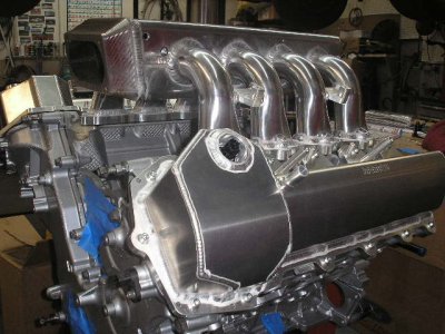

today i installed the gt500 pump system. it was really easy. a pleasant surprise to say the least.
i wanted to do that before i tear into the car just so i didn't have to worry about any issues with that while trying to work out the bugs with the new engine and stuff.
here's a pic with the moroso valve covers and the JPC intake together.

Those valve covers and intake manifold look kick ass on your engine.

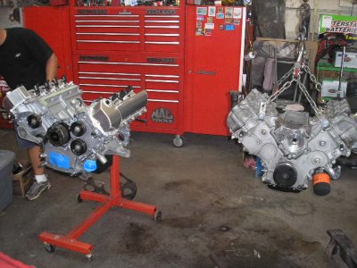

here's some pics of everything disassembled. yeah i'm not wasting any time now.
had some issues getting my balancer off. the march fluidamper balancer has a wide spread on the bolt holes and i didn't have a tool that would fit. had to go rent one from advanced auto parts....we have over $100k worth of freakin' tools and i couldn't get the stupid balancer off. finally got it switched over today so i'll have the engine set down in tomorrow afternoon and start figuring out where to set the engine mounts and headers. i have the hooker L/T's and i think they will clear with the exception of one tube on the drivers side which will most definitely hit the steering shaft. it barely cleared with the 4.6 so no doubt it'll hit with the 5.4 being wider and taller. the passenger side should be fine. i'm going to have to lower the engine about 1" though. not sure how but the prothane mounts have plenty of meat so i might be able to just machine them down a bit and rethread them.
FYI other stuff : i bought an SFI flexplate that fits a 99-01 4.6 with the 8 bolt crank (windsor plant motors i think) and it did fit but i had to cut the the extra threads off studs on the torque converter which hold the stock 05 adapter plate to the converter. other than that everything seems to be fine.

oh and the 5.4 oil pan wouldn't work due to the difference in the sending unit ( i tried them and they are not interchangeable). it(5.4) was a better pan since it had more capacity as well as having crank scrapers built into the front area of the pan like the old cobra pans had.
it also did not have the clearance hump for the rack unit like the stock pan. not sure if that would have made a difference since i do have an aftermarket k-member but i didn't want to chance rewiring the harness for the 5.4 oil sensor so i just swapped pans. later i may switch to a moroso pan but i think the stock pan will work fine for now.

Ron. If you can't get enough clearance by cutting the Prothane mounts, Maximum Motorsports makes 1/2" K-member spacers that will lower the K-member for additional clearance. However these are for the SN95 Mustangs. I'm sure you could fabricate something similar.

good idea. we actually just did that on my brothers fox body t-bird drag radial car. i think my issue is going to be mainly with one header tube. since we just made a set of stepped headers for his car so we've got plenty of left over tubing so if it needs to be moved i'll just rework the headers.the jet hot coating is coming off anyway.
i've got a feeling the rk sport hood isn't going to clear but i'll try my best to make it work if i can only because it's a functional ram air hood and when it's sealed to the CAI i do gain a couple mph from it. worst case is i sell it and get a cowl induction hood for clearance.
