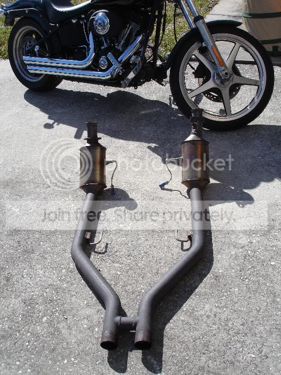

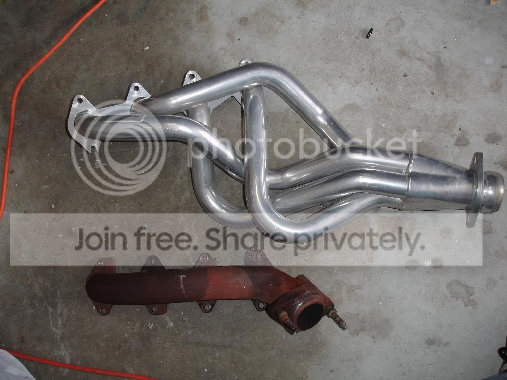

Got the Cam Covers on, fixed the fuel lines, dropped the exhaust, took out the stock H-pipe. Got the driver side exhaust manifold off. Got hungry so break time...

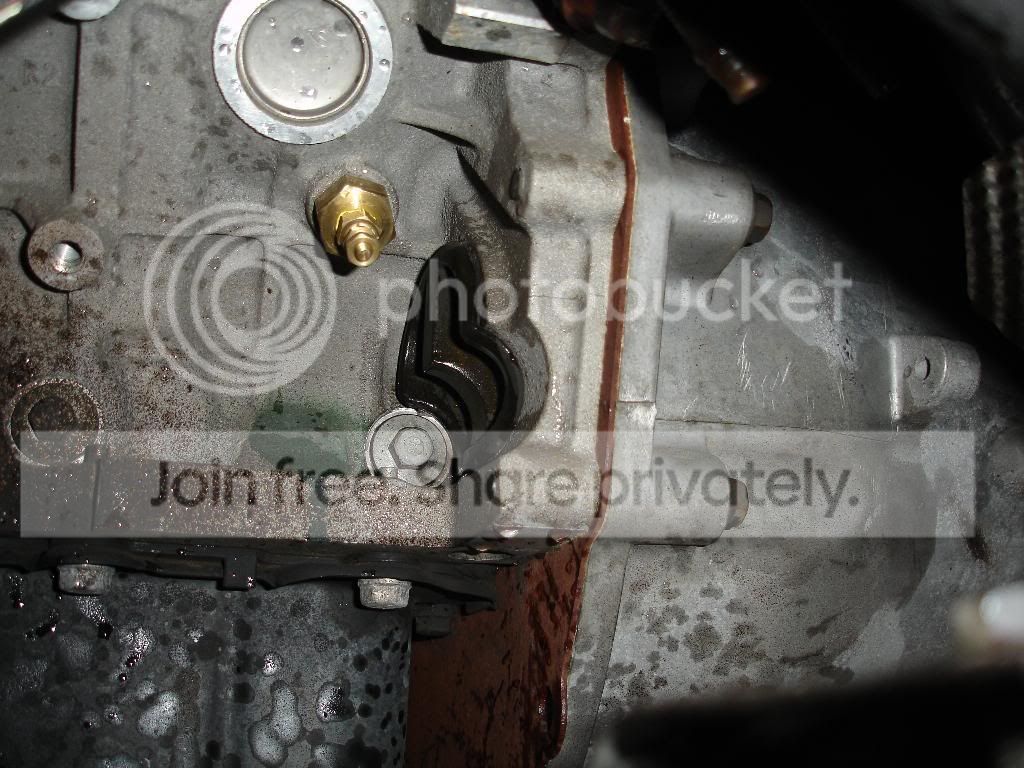

This is the Water Temp sending unit...
Where was that located? I just bought a temp gauge today and was gonna put it in but it got dark out. Also was it a stock place you put it in or did you have to drill it? Any help would be greatly appreciated!

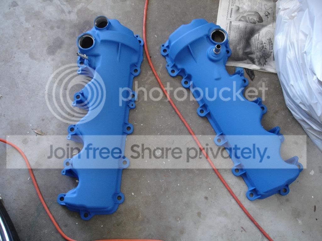

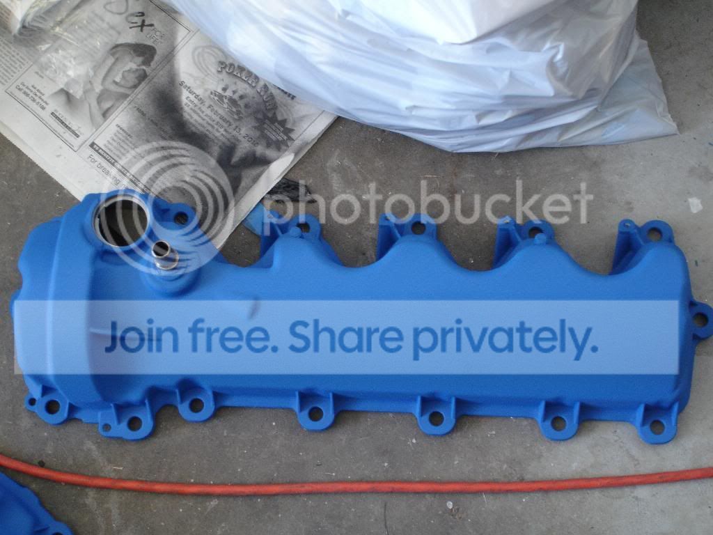

i like the wrinkle on the covers,who did them and how much was it,ive been debating on doing mine.
$80.00.. However he may charge more next time. He said he had to put two coats on them cause the damn porous metal these are made out of. http://www.sharpcustomcoatings.com/

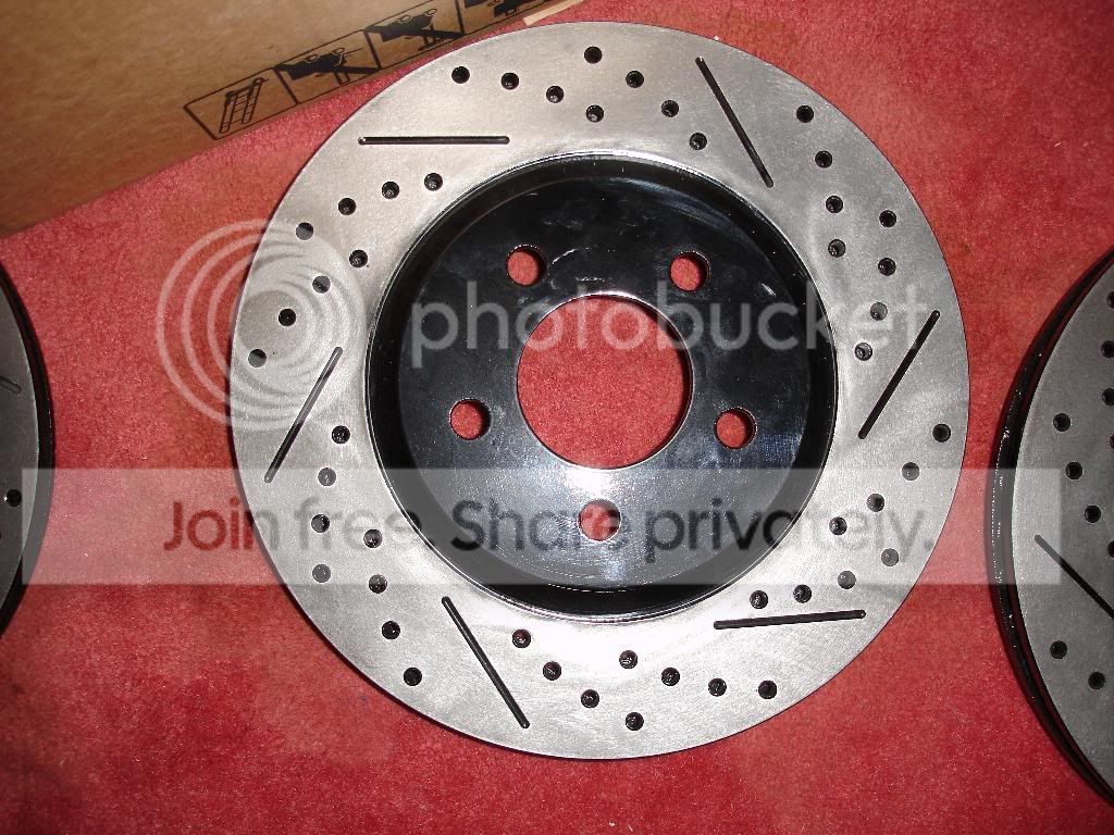

Rotors like that is what I want to go with the next time I need brakes.
They are the BAER Decelerators, I had them powdercoated black. Also had the slots and holes powder coated...

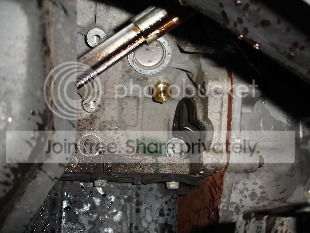

It's Autometer Part# 2268, it's a pre-drilled plug on the driver side towards the rear. You can access it from under the car. Just have a bucket ready cause you will lose alot of fluid when you take it off.
Also here's from autometer...
Water Temp Location and/or Thread Size
for 4.6 engine(s)
Look below the last freeze plug on drivers side (left side) of the block. There will be a threaded in plug (16mm x 1.5). This can be accessed and removed from under the vehicle. For electric gauges use an Auto Meter model #2268 adapter. For mechanical gauges use an Auto Meter #2275 adapter.

thanks bud!

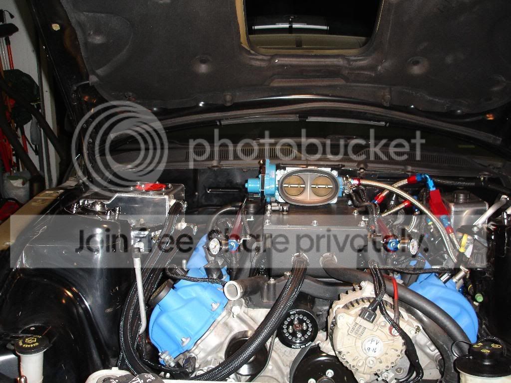

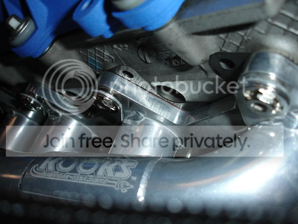

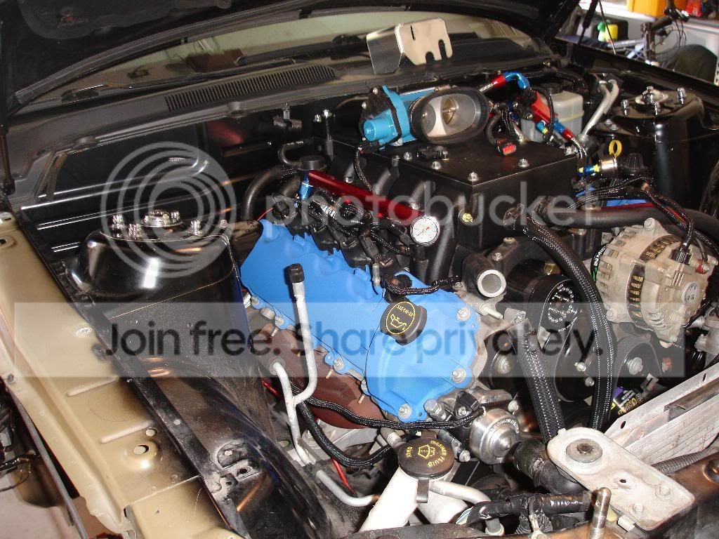

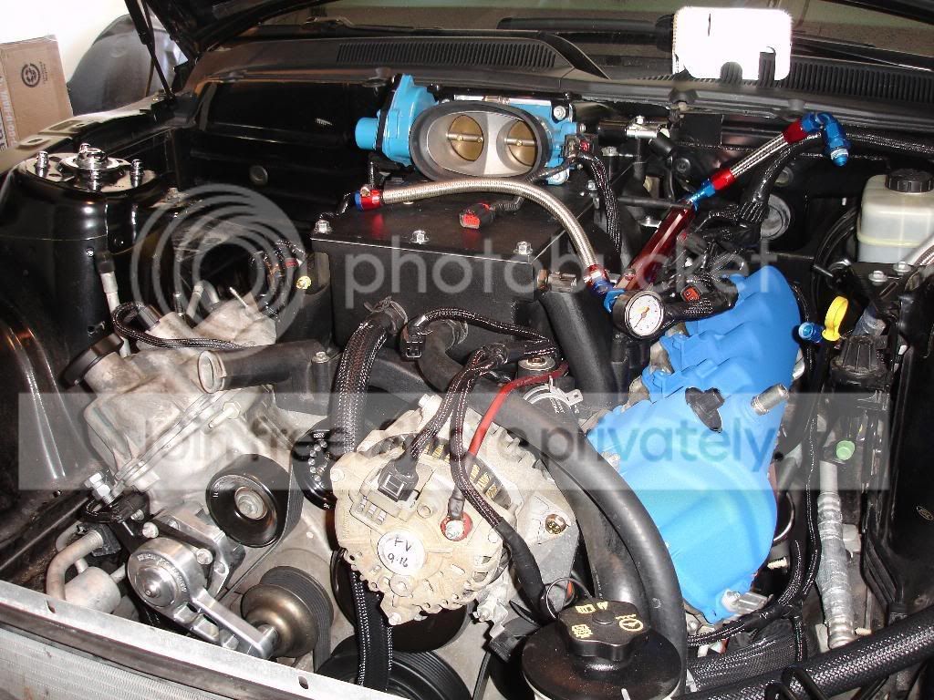

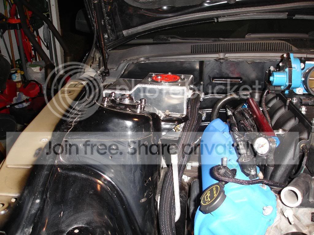

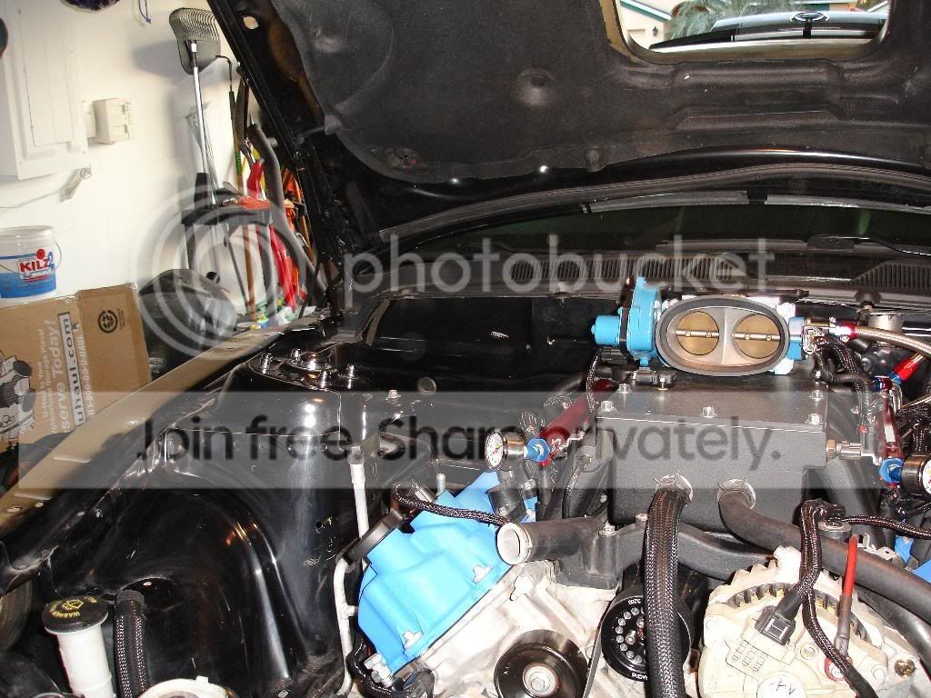

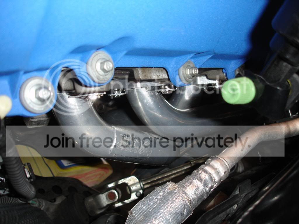

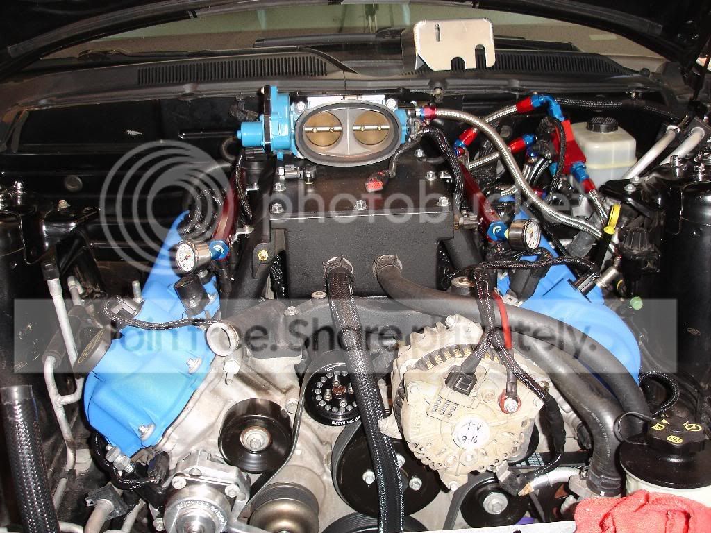

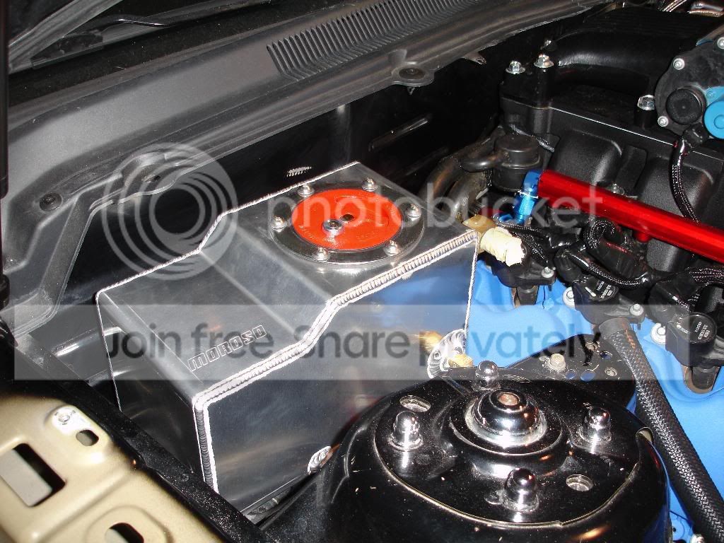

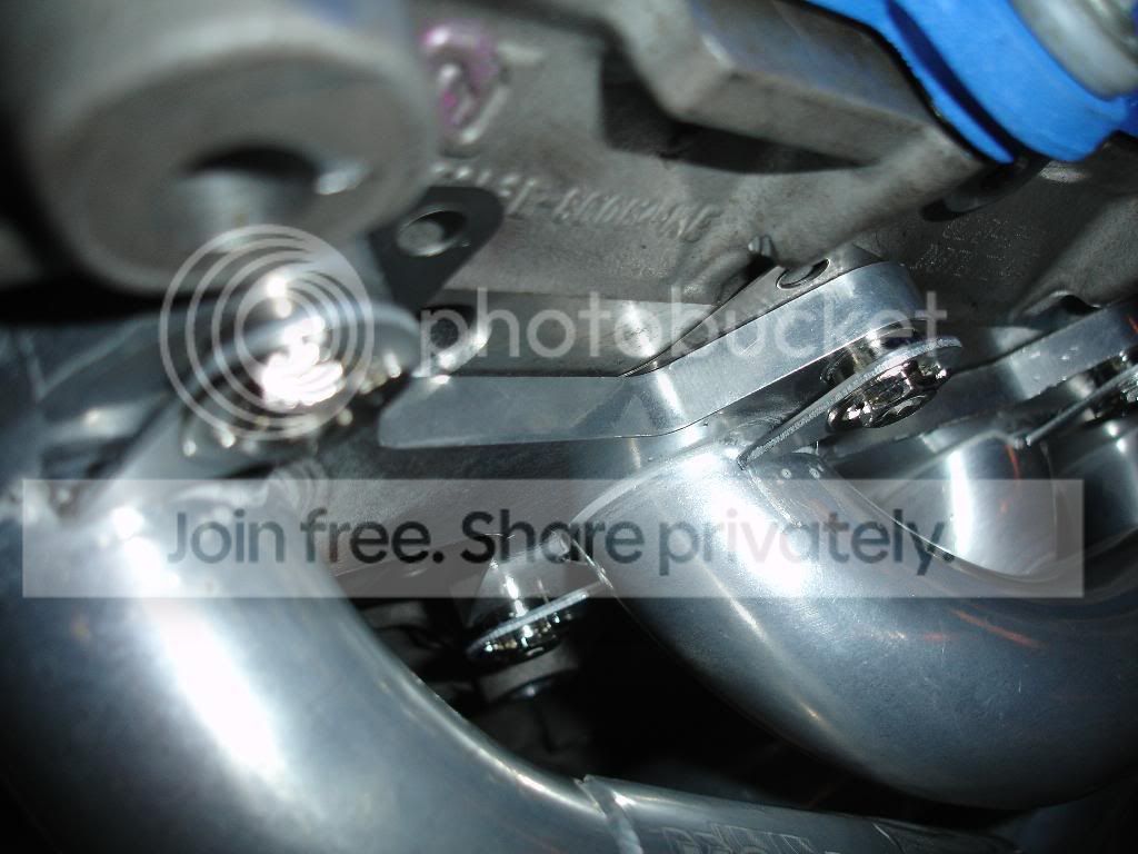

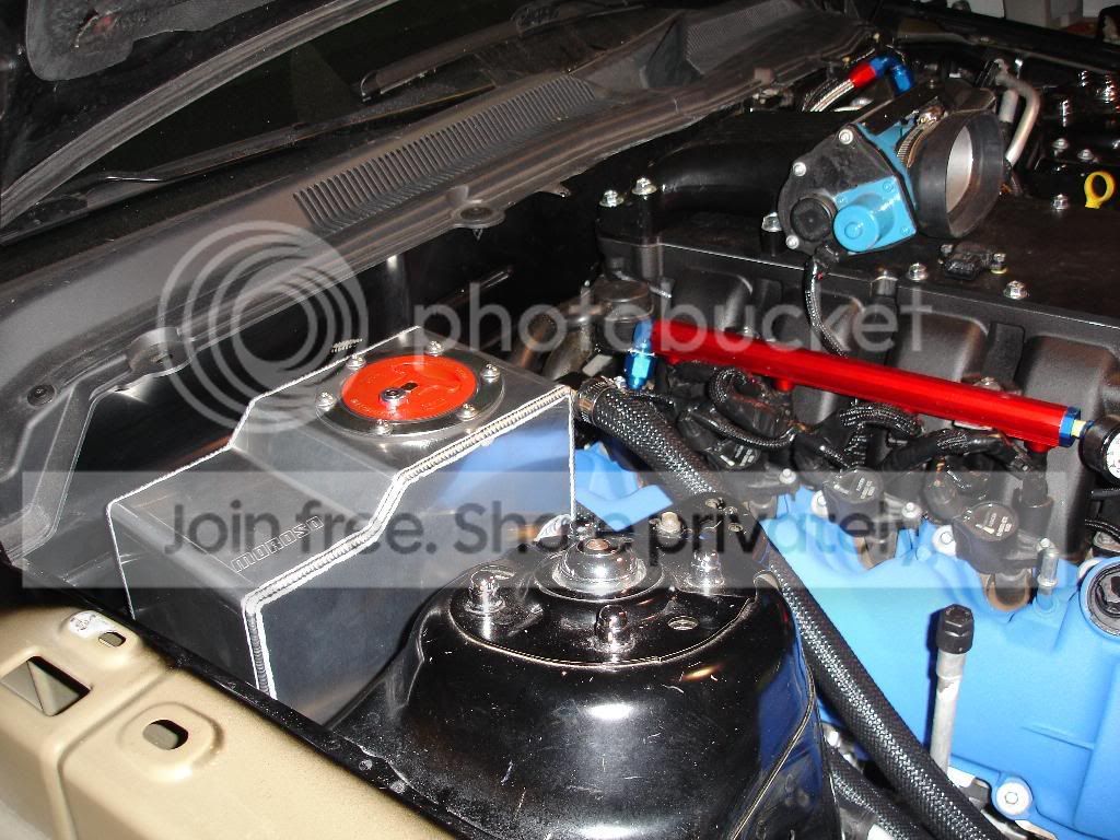

Headers on, Exhaust rehung, intercooler tank mounted... starting the breather cans.
Stage 8 Locking header bolts.
Stage 8 Locking header bolts...

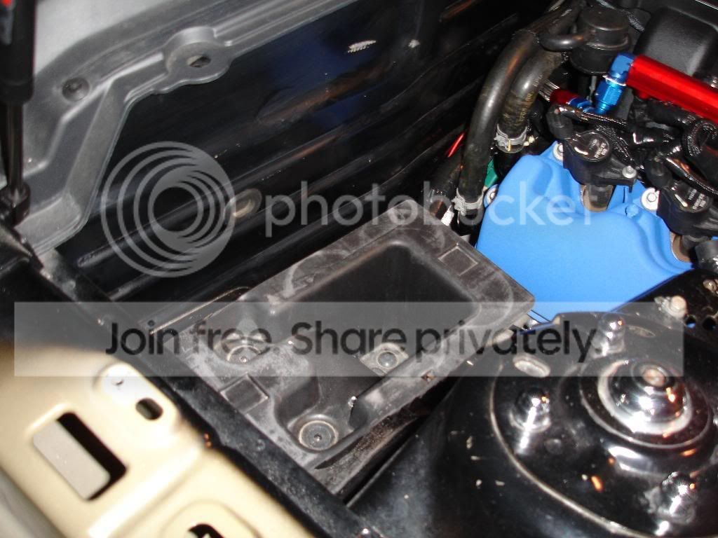

Battery location intercooler tank...
Trimmed battery tray...
