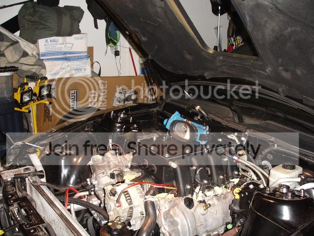

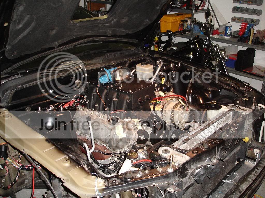

So about that... lol... Like all thing motoblue, they are never right... The 1/8" port they put in the block for a guage is cut to close to the end so any sort of coupler covers the hole. No problem, I bought a swivel with the 1/8" in it.
Second, my dumb ass didn't buy the plugs for the ends of the fuel rail. No biggy, ordered some more.
Third, The couplers they sent weren't the o'ring side to hose. They were both the beveled hose ends so when I put them in the fuel rails, it covered half the back injector holes. So I re-ordered the correct ones.

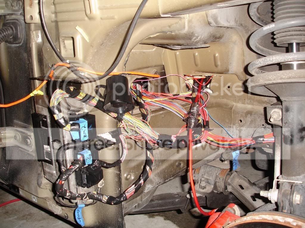

I checked the continuity of every connection: (BEFORE)

you now you are really going to need to do something with those valve covers!

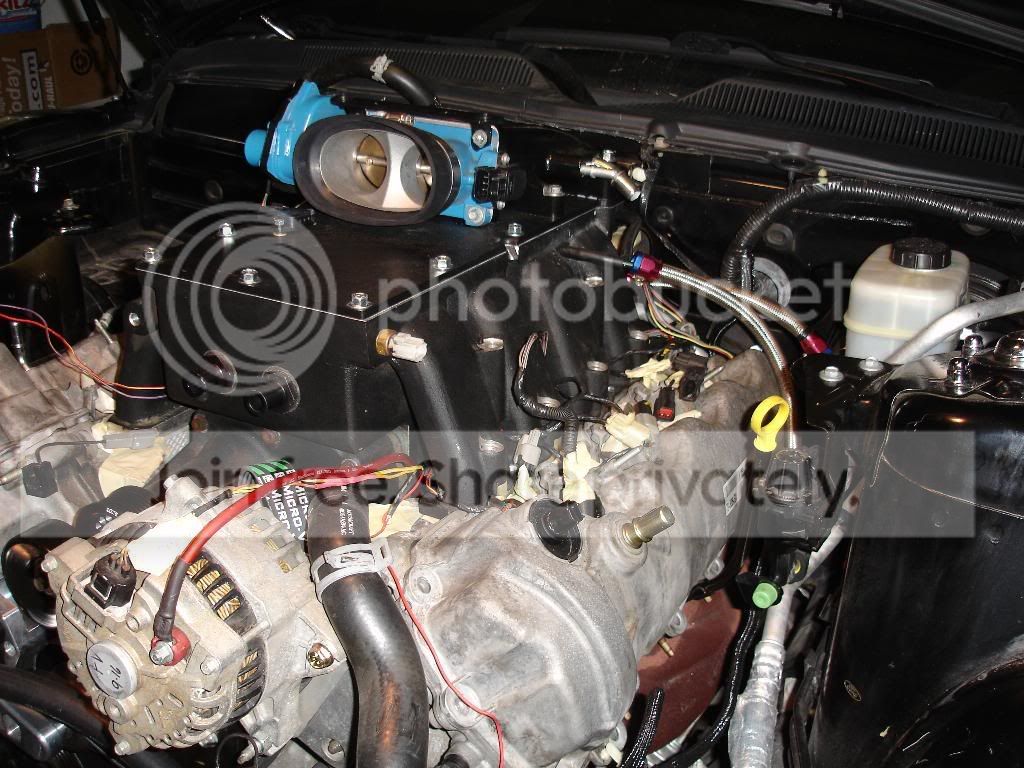

That is an interesting way to mount the alternator![]()

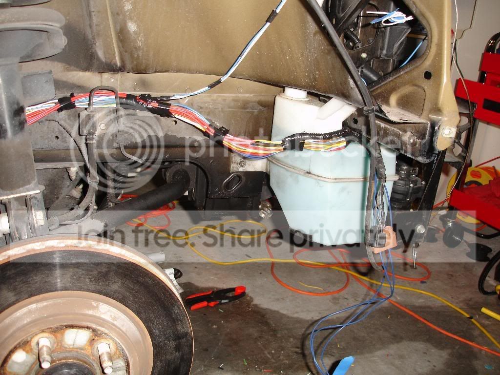

Wiring is looking good . I have about 60 hrs in mine but I redid it all specific to my car . HIDs and all as well as moving everything that was in the engine bay under the dash . Keep it up , you are making good time .
There are 3 thin spacers that go behind that Saleen alternator bracket that are critical for proper spacing. I can't tell from the picture for sure...are they there?
