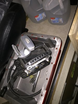

Just an update on the thread, the car is sitting in the garage with no transmission because it decided it wanted to take a shit on me a couple weeks ago. Good thing my dad "05stroker" knows some really good connections, had Wille up at Park Cites Ford take a look at the transmission. Come to find out the main clutches were gone:omfg:but with the power of Willies knowledge and the power of his hands we will be picking up the freshly built transmission this coming friday. Bringing it home going to put in some goodies like a TCI 3500 stall converter, billet input shaft, and 3rd and 4th gear servos. While the transmission has been out we went ahead and put the AMR LT headers and O/R X-pipe on and a TCI Ratchet shifter. Here are some picture of my car and its changes throughout the last year..
