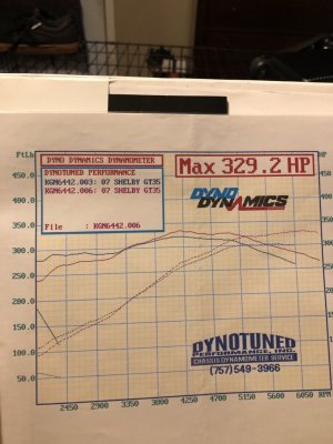

I have the dyno sheet and mine put down 329. I was looking into going with 4.10’s, but after some research on here I figured 3.73’s would probably be better with boost being the goal. Didn’t know if these cams usually lagged in the low end or if there was some great supporting mod such as a throttle body or something that could help.

Should’ve posted the dyno sheet. Didn’t even think to look through the receipts and stuff I got with the car. Car has Mac long tubes, Ford racing cai, catted mid pipe with Mac pro chamber, borla axle back, bbk ud pulleys, and hot Rod cams. Assuming it still has the stock TB and it still has the 3.55 gears. The tq down low is terrible down low and I know it could be the cam profile among other things.
Don’t have much experience here so does anyone think I should get ahold of Lito for a new tune or go ahead and do a tb and gears...or all of the above?

I have always wondered why the 4.6 (all versions) feel soft on the bottom end. They have a respectable stroke. And it seems the bore shouldn't cause it to be soft. At least not directly. Which leaves the port airflow and cam specs as the likely culprits. I've long wondered if a custom set of cams would correct this feeling. But in the end it only has 281 cubic inches to work with.
The best 3V cams for torque from off idle to 4400rpm are the OEM ones. Mine pulls briskly from 1250rpm (40mph) in 5th gear no problem. The perception of a "soft" bottom end is due to the sharp rise in the torque curve from 3300-4400rpm (stock cams) where the WOT cam timing retard begins to kick in to add more sparkle at higher rpm.
A stock 3V actually produces more low rev torque than a stock pushrod 5.0 which was fabled for its strong low rev torque, and the VCT also helps the 3V produce more low rev torque than its 4.6 2V and 4V brethren.
Just about all performance cams cause a torque loss below 4500rpm to varying degrees. Long tube headers, a 62mm TB, and higher ratio axle gears can mitigate it but there's no getting away from the effects of a longer duration cam on a relatively small displacement V8.

In the 4.6 3V you certainly give up a fair chunk of lower rpm torque when you opt for a bigger cam (Shelby Steve's torque curves graphically illustrate just how much). That effect would become even greater if you opted for a cam that requires cam phaser limiters or lockouts (SPR cams), thus reducing or eliminating VCT functionality. Those cams work best with ported heads that'll allow you to take advantage of the increased airflow at higher valve lift. Since the heads would also come with upgraded valve springs, you could rev the engine as high as ~7250rpm if you add the Ford Performance intake manifold with its shorter, wider runners.
