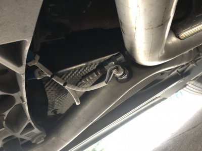

Well the defoulers are in, perfect fit next to each other. Zip tied sensor wires out of the way too. New tune is in, gotta get my SCT stuff set back up on my laptop and throw it on there.. will keep you guys posted!
Did you make certain that your rear 02 and catalyst monitors are turned on in the new tune? In the meantime, most definitely keep us posted with your progress regarding the non-foulers passing the OBDII scan :waytogo:
