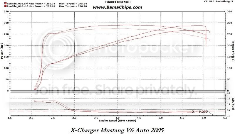

Here's Mine running a 93 mail order tune from Bama Chips:

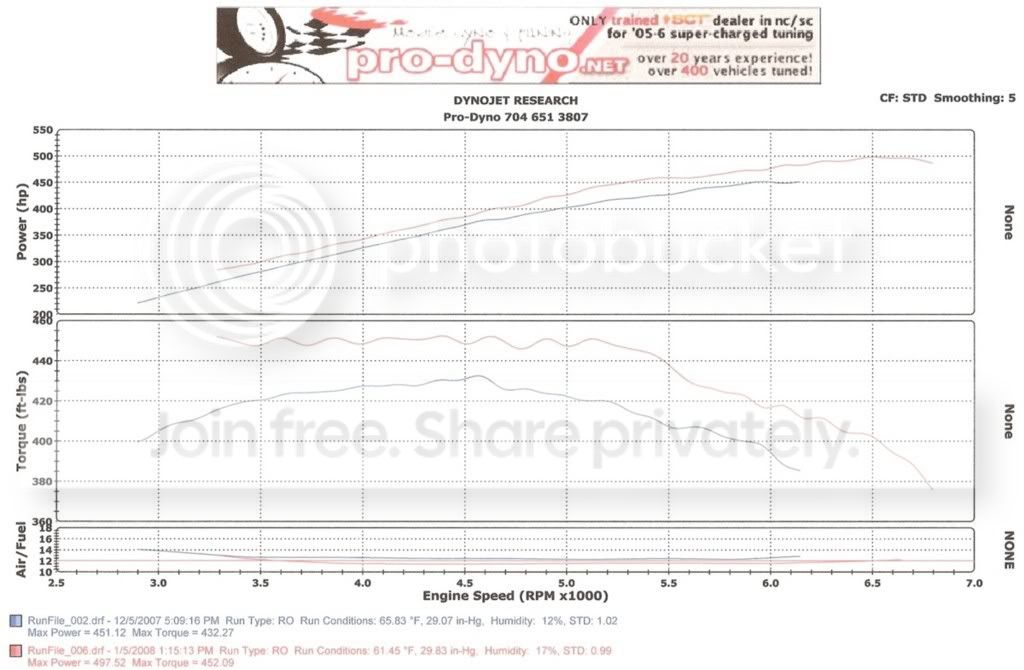

and heres mine with a custom tune from Pro Dyno:
Stock fuel system & JLT2 CAI

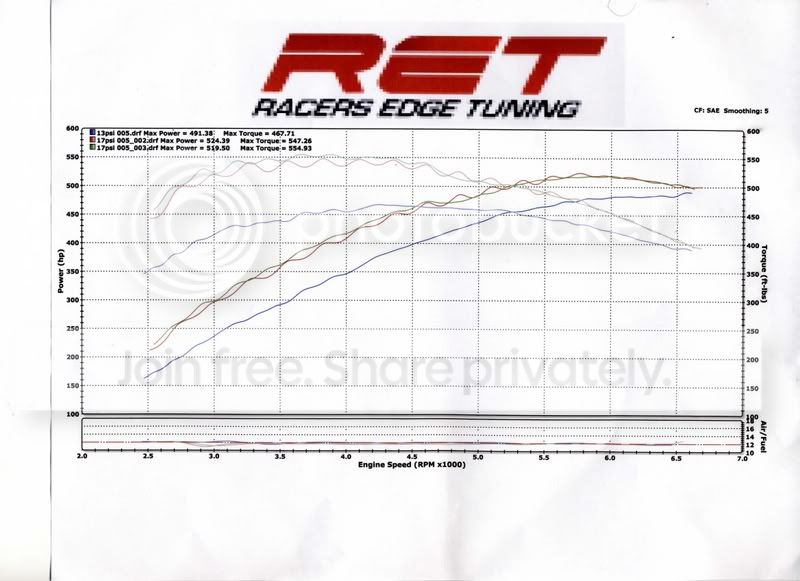

16*/ GT500 fuel system/39#inj/Stock maf in Whipple housing.
blue is with smaller injectors and 8psi, red is with 10psi and the 39# injectors.

Blue line is w/8psi pulley & Kenne Bell canned tune
Red line is w/10psi pulley & Pro Dyno custom tune :snoopyGT500 pumps, Spydershaft, FRPP shorties
