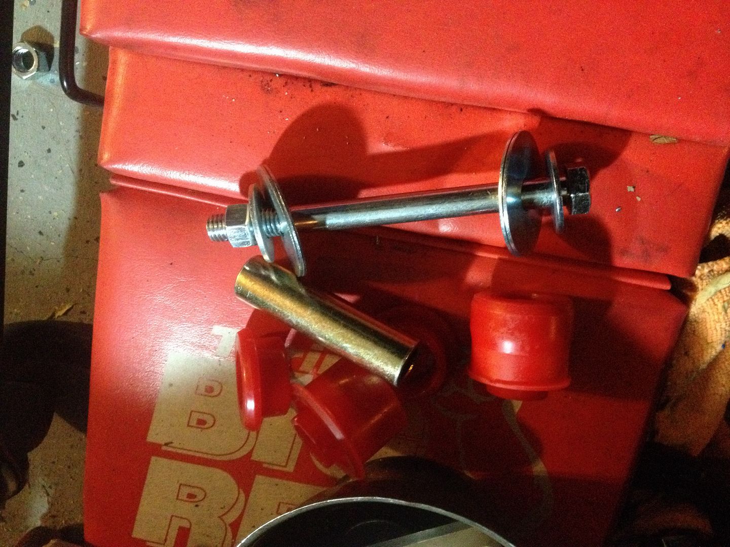

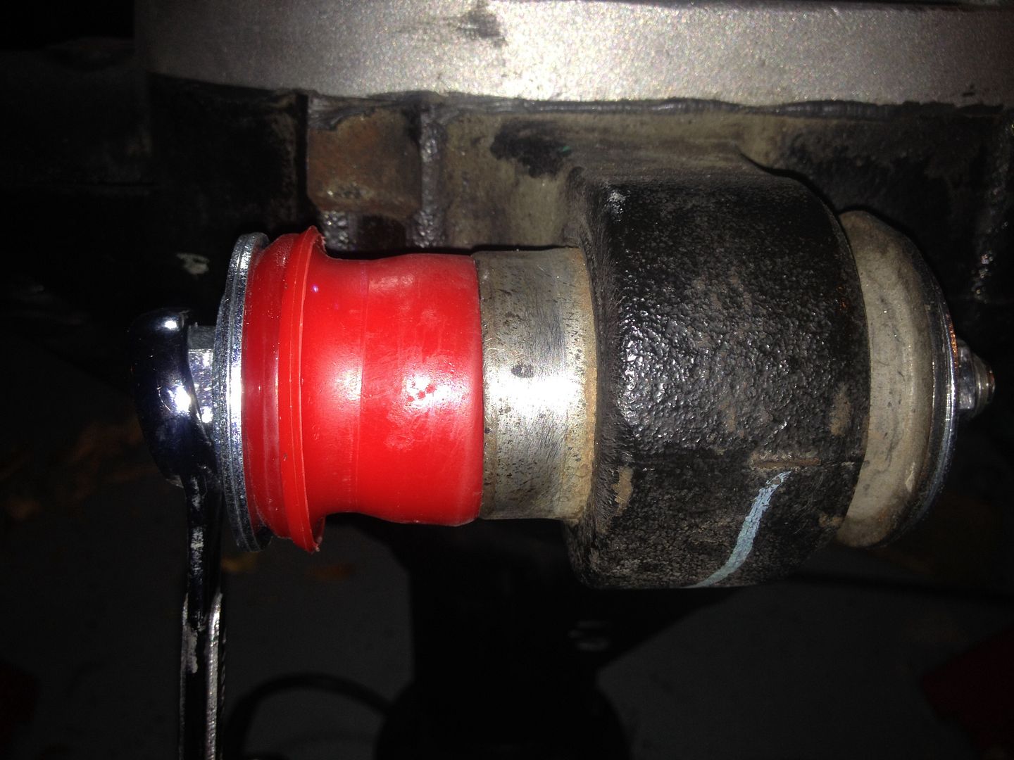

I was in this position at one time putting my BMR bushing in. Could not force it in there.
I found out something pretty amazing though. If I remember correctly I think I solved this issue by inserting the bushing from the other side. I think it was 10 times easier. I actually like the design as the actual bushing expands when you torque it down. Here is what I put together to press the bushing into the sleeve. I think I had two different length bolts. One to get her started and the other to get it all the way in but in hindsight the longer one with more threads would have worked.
