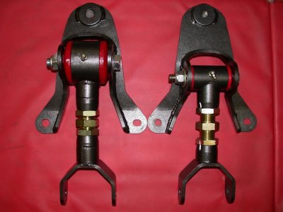

Look at this picture of the BMR 05-10 UCA & mount vs the BMR 11-14 UCA & mount.....focus on the UCA poly bushing design differences.
This picture validates my concerns\decision to remove the BMR UCA diff poly bushing & install the Ford part# DR3Z-5A638-A UCA diff bushing to reduce UCA bind\twist on axle articulation as I have the 05-10 setup installed which, as you can see, has little to no room to flex in the poly bushing of it's UCA as opposed to the poly bushing design of the 11-14 UCA so the majority of axle articulation flex\twist is thrust onto the UCA's adjuster & UCA diff bushing w\ the 05-10 BMR setup as opposed to the 11-14 BMR setup which explains why my BMR poly diff bushing did loosen up over it's time under operation (as noted in post #41).
The 11-14 setup is on the left, 05-10 setup is on the right:
FYI...…………………...
FYI...…………………...
Spot on. 11up less bind.
I put the QA1 upper on mine. Spherical bearing on tbe chassis side. Left the stock bushing in the rear. I like it and didnt really increase cabin noise. Which I was expecting.

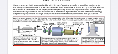

I just recently pulled my Upper rear housing bushing using instructions from Steeda. Figured this would be a good place to post it up for others. Works great... 3B716D0E-D683-4AD1-B084-7A8656560FFC.png

I just recently pulled my Upper rear housing bushing using instructions from Steeda. Figured this would be a good place to post it up for others. Works great... View attachment 72665
I went down this route rigging up my own version of the OEM tool as this diagram describes. Finding an all-thread that is hardened enough is difficult.
Any idea where to find something like this?
I used stainless all thread. Standard should work as long as it’s well greased. Whatever you use grease the threads well. I got everything from the machine shop that does my powder for less than a 20. You can also use a grade 8 bolt and nut but go in from the opposite side. Cheers

If you put some silver antisieze on the threads, it helps a bunch. But allthread makes a one time use bushing tool.

Luckily it’s an s197 and not a fox or two lengths would be needed. Lol
Absolutely. lol, Yes, I had to "replace" the allthread to do the second bushing on my 91.
You can assist the allthread tool with a hammer. Tighten, tap, repeat.
