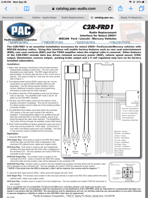

Hi,
I have been dealing with this since February myself.
I have a Kenwood DNR476s nav unit. I tried a Maestro interface, however it does not support 2005-2006 Mustangs. Wasted $180. Then I talked to Kenwood and Maestro. Kenwood only supports Maestro for idatalink connections. Even Crutchfield said they could not help with a 2006 Mustang.
However I purchased a PAC C2R-FRD1 interface. I call PAC and were very helpful. I installed it last weekend.
The PAC unit has an MSCAN connection keeping factory features. No need to connect to the park brake or backup lights as well as 10 minute delay shut off of radio. It even takes care of front door amp voltage .
I bought my PAC interface on ebay $60
Without the MSCAN connection, a radio replacement will still work, but this interface makes it plug & play
Hope this helps

Great,
with the PAC unit you will not need a converter, as the PAC provides the correct voltage. No need for em brake or backup to car. Those wires from the PAC go to the radio instead.
Any questions , just ask.

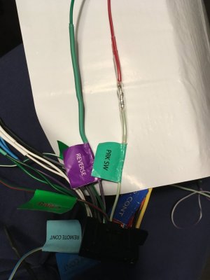

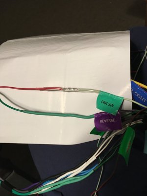

Hi, Be very careful with the PAC park brake wires & reverse wires.
The PAC colors do not match up to Mustang colours, I just did another one tonight.
Even if you do not do a backup camera, hook them up .
Ken K

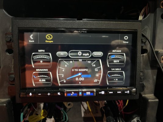

Update on my 05 head unit upgrade. I used the PAC C2R-FRD1 and it all works perfectly, even the factory amps. The speakers and amps sound even better than the Shaker did.
Thanks for the help.
