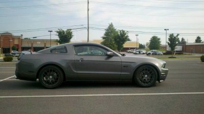

I ran out to the parking lot and took a picture of my Pony.
Steeda Ultralite Springs, Maximum Motorsports Caster/camber plates, and Koni Yellows. I'm running '05-10 front struts with the adapters from Maximum. This is how my car sits.
The front does not seem too low to me at all. What CC plates. And stut mounts is everyone running?

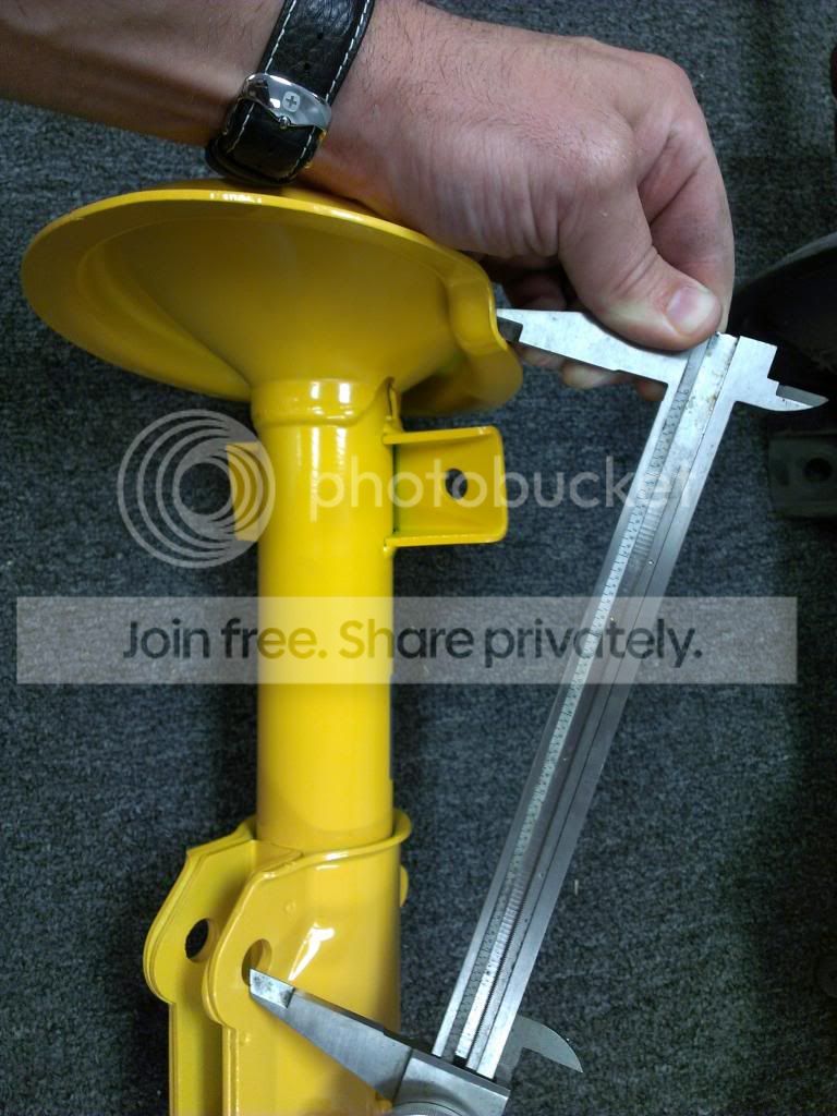

I just did some measuring.
Koni's are 1/4" shorter.

Why isn't my car sitting too low in the front, then? Is it because of the adapters that Maximum Motorsports provided with my plates?

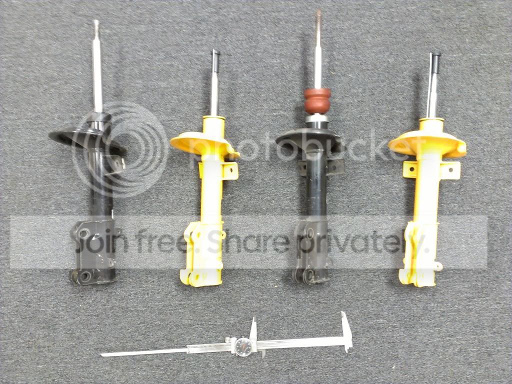

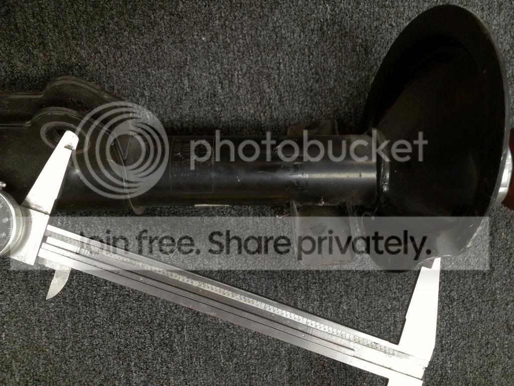

From Left to right:
2011+ Stock / 2011+ Koni / 05-10 Stock / 05-10 Koni
The Koni's both measured the same, from upper strut bolt to lower spring perch.
The stockers both measured within 1/16", from the same upper strut bolt to the perch.
As you can see, I set the calipers to the length of the stockers, and compared it to the Koni's....and it appears the Koni's are atleast 1/4" (more around 5/16") shorter. That should almost be a linear effect, causing the front to be roughly 1/4" lower with the Koni's.Glad I could help.

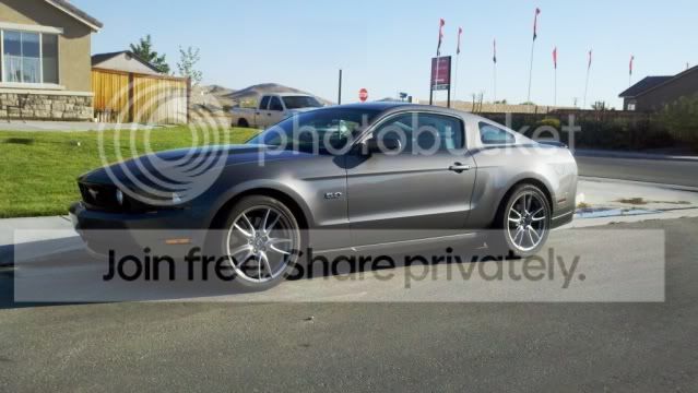

Sky, your front doesn't seem too low.....but your car definitely has a decent rake to it.
I would say it had a little more rake than it should, but I can say that these cars work well with rake, so I wouldnt be worried at all.
Here is another pic of a similar car, with the same springs. It may be just me, but your car definitely sits different than this one:
The car had a rake from the factory, so I just assumed it was still supposed to have one with the lowering springs!

I know they have rake, stock, but yours seems to be a little more pronounced.
I wouldn't worry about it.

Oh, I'm not worried about it. I also think the -2.0 degrees of negative camber I have up front makes it look a bit lower than it actually is.
