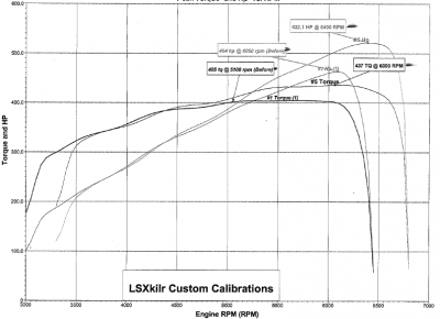

2008 Mustang GT - MPH (Modular Power House) Series 2, #2 - second owner. I didn't get any documentation on engine mods.
Vortec V2 (tapped engine oil), not V3- original pulley, intercooled
JBA Shorties
Detroit Rocker SC grind
Snow Stage 2 water/methanol injection
522 rwhp custom SCT tune on LSXKilr's loaded dyno
9lbs boost, 91 octane pump gas, baseline before cams and after cam install pull:

Thanks for those! Really nice graph and on only 9lbs! S trim or T trim? That's perfect power for me. Also did you tune for the meth and add timing or is it there just to keep IAT's down?

MPH installed the blower before this car was sold new. Somewhere I have the build sheet from Modular Powerhouse with the specs, but I haven't seen it since the basement got remodeled- its down there somewhere. I'm pretty sure it is SI trim, though. Meth is to add timing.
