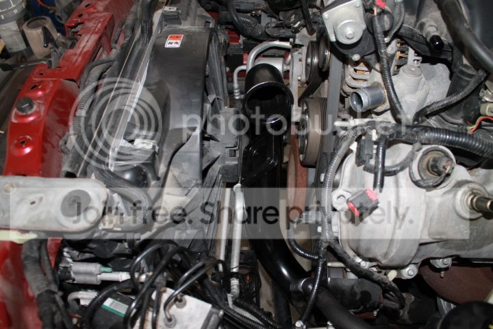

Cats off that was not easy and I boke one of the studs on the drivers side. Had to drill out both bolts in the exhaust manifold on the drivers side.

I have no idea where the small u shaped tubing with the red caps goes.
Dont feel bad...I didn't either. Its not in their install photo and I could not find it in the instructions. Looks like you are also missing the second half of the intercooler bracket. It looks like a stretched out Z. I didn't have it either.
